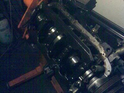

Re: Will a fwd ca18 bolt up to a rwd box?
2005/3/31 3:06
From Adelaide. SA
Posts: 921
Um... its a bit difficult to explain but the RWD has a set of main caps all joined together... like a set of webbing I suppose. For example if you wanted to remove the rear main cap you would have to remove all of the main bearing bolts and all of the caps because they are all joined together. where-as the FWD has each individual caps (like an A series)
I will post a photo up in a tic to explain.
Posted on: 2008/6/23 8:41
2005/3/31 3:06
From Adelaide. SA
Posts: 921
Its a bit of a dark shot because I just took it with my phone but you can see the "cradle" that holds the main caps.
Adam.
2003/12/3 7:56
From Christchurch NZ
Posts: 3706
Thats the girdle. IFAIK, the early motors dont have that. But the later motors do. I bought a FWD Ca18det in bits for a box of bourbon an colas. The guy who I git if off had give the Girdle to another mate of mine because his earlt motor didn't have one. I then scored all the gizzards out of a mates dummy block, and got a girdle with that lot.
