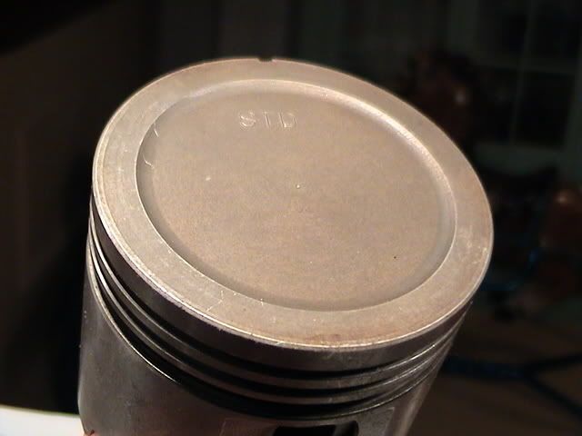

Thanks for the correction on the A15 pistons Dodgeman. I remember using a set to increase compression on my E16. They are a direct replacement for the E-series. I have a thread about it with pics here. You're right, they won't work properly in an A14.

I had a look at your link & clearly, your a15 pistons are VERY different from ours, so US model A15's must have a larger combustion chamber that the Aussie spec ones in order to have the same or similar compression ratio's. We NEED US spec A15 pistons.
Your US spec A15 piston.
My Aussie spec A15 pistons.
Left side is a factory A15 piston with a new 'replacement' A15 piston on the right.
These have noticeably more bowl than US ones.
The rods are from an A12T [120Y GX] [left] & A12A [right]
