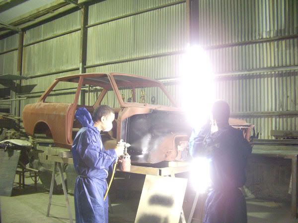

Vince and I put the first coat of Interlac 688 (sorry not IG68) down last night. It looks okay but you can still see much of the abraided steel. So I'm putting a coat of Interprime 198 on top and then a final coat of 688 to give it a nice finish. Here are a few shots of progress/results.

So I stuffed up a bit by putting the Interlac 688 on too early. I was using alot of paint because of the rough surface (if it were a smooth surface you would need much less, smaller surface area).
So I got back into it and put a coat down of Interprime 198 which is a high solids (41%) primer and a great base to build off.
All the paints, primers are compatible, that's the great thing about using multi-purpose surface coats. So putting the Interprime onto the 688 is fine, no issues whatsoever.

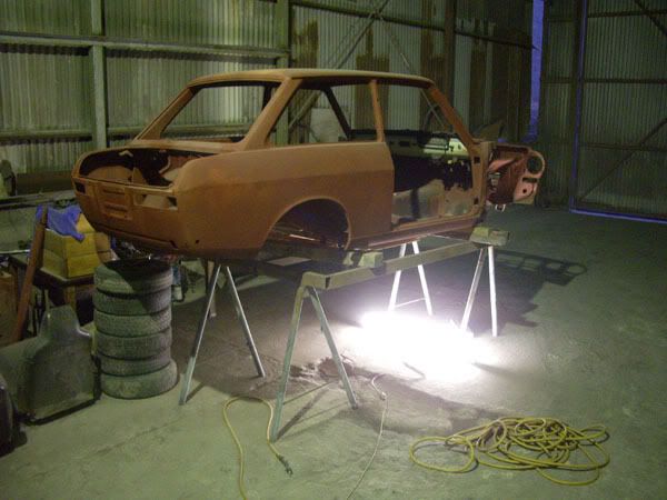

Here are some shots of the rusty parts....sweet #### all to be honest. All patches were cleaned and cured so don't think I'm just painting over them. The places where the high solids primer have dripped will be worked over. I really had to lay it down in some places.
The spare wheel well has holes through it. It looks like it rusted through from the inside so I'm thinking about filling the holes and putting a fibre-glass lining in, see how it all goes I suppose.
I'll attempt to put the second coat of black paint on the underside. It's saturday though and the pub is mighty appealing.

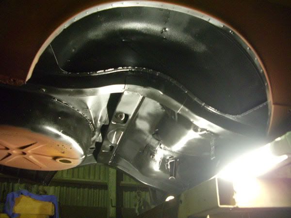

Second coat of Black Intergard 688

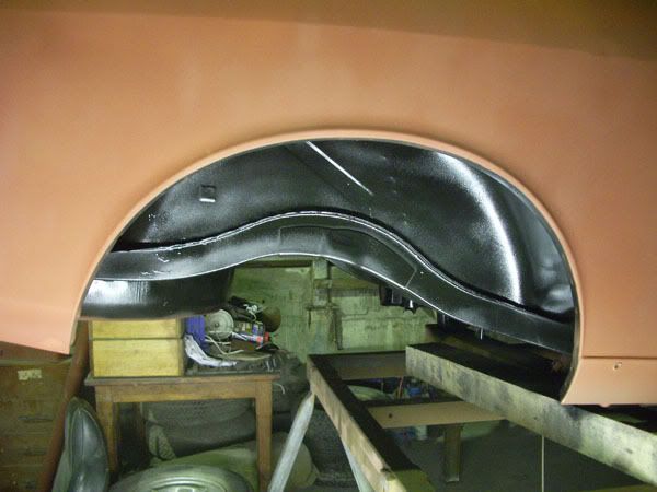

Rear wheel well with second coat Intergard 688

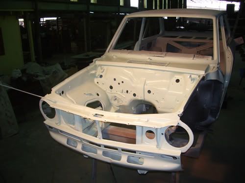

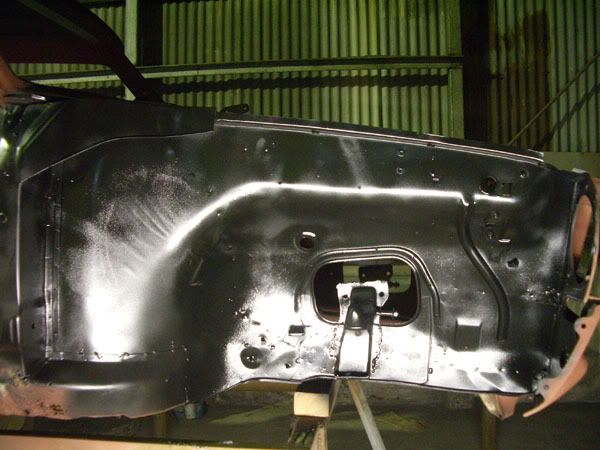

Front apron and engine bay with Lesonal 410 Fast Dry Primer (flashes off in about 5 minutes!!) same bloody colour so no differences in the eye of the spectator. That's me in the photo....bit of a day dreamer.

I rubbed the engine bay, apron, pillars and windows down for the final coat. The colour is absolutely bizarre but I am warming to it. It is a kind of green tinged white, sounds feral but it's okay.
Here is the pillar with a nice, generous coat.
The front apron with the coat on, it's turning out okay, I'm not yet happy with it so I might take to it with some sand paper and get another coat on.

Forgot this picture, over the engine bay.
