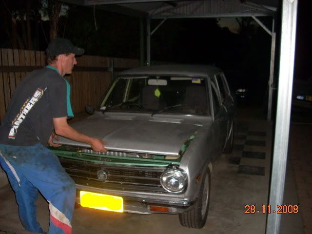

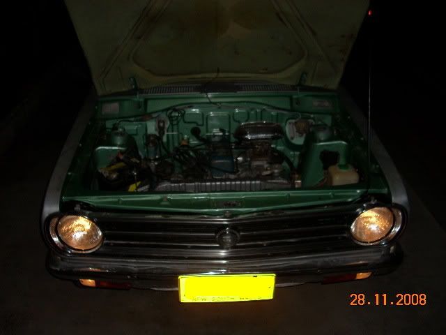

DatsAndy Posted on: 2008/12/25 10:04
Back On the road, Night shots at the misses place, Oh the Misses Took this One Sneaky
Goes much better with A14 and Weber. Also better brakes Thanks Levey for the new Dual circuit Master.
