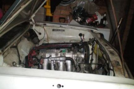

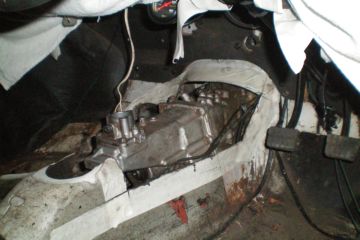

There is no turning back now. We have been busy the last week or so. We braced to motor and box, trans tunnel is gone (sorry Andy). We made both engine mounts and starting the gearbox cross member now. We got it sitting very nicely and im happy with progress so far. Not to many major headaches. The dizzy is my biggest problem at this stage, I can box the fire wall but its not in a good spot or I can get a right angle drive custom made but its going to cost me. Im leaning towards the right angle drive. This costing so much more money than thought, anybody thinking about a conversion, do a budget then add $2000.

im sorry andy, no more cutting I promise
offside engine mount
nearside engine mount
so far so good, sits in nice apart from the dizzy

Re: G13B into my KB10
Instead of a right-angle distributor, why not fit crank trigger? That's only $200.
Posted on: 2009/1/19 0:18
2008/12/8 4:45
From Sydney
Posts: 471
I thought about that and I would love to but, I need to run a standard ECU to get it passed by an engineer. Which sucks cause one day it most likely have an aftermarket ECU anyway. You got to love the RTA
