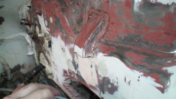

We had half a day of sun today. We already had wet rubbed it and dressed all the holes we welded up. No battery support, no fuel filter clip, welded the big holes on the inner guards, chopped drain for pleniumn. The wheather was not ideal but we went for it cause we are getting too far behind. It turned out sweet. Cant wait for the colour.
Chopped drain tube, fouls the thermostat housing
ready for the primer, cant believe the wheather but a bit sun came our way
Came up good I think, Im happy with all the repairs. Drain tube looks good
Battery support gone, came up sweet
Holes for harness and squares holes for plug gone, im happy with this aswell
Posted on: 2009/2/21 6:51
