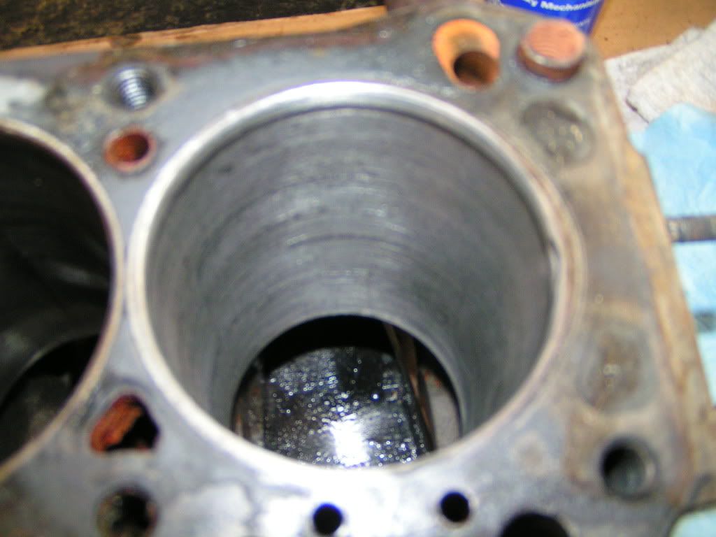

bad hole....
maybe better hole now...

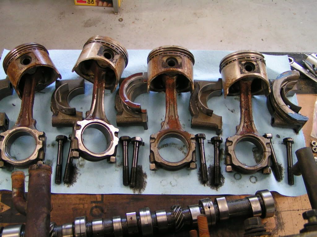

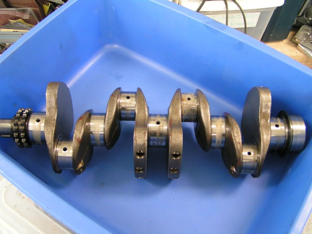

a few more pic's..

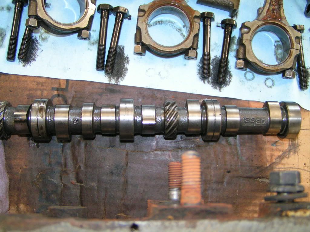

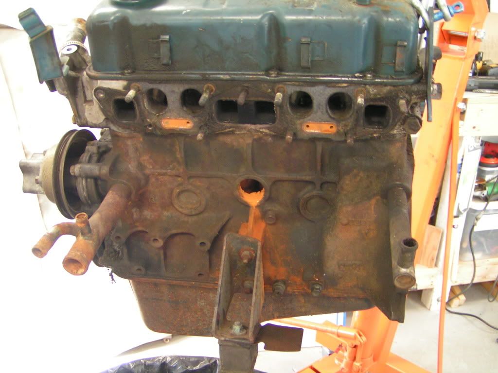

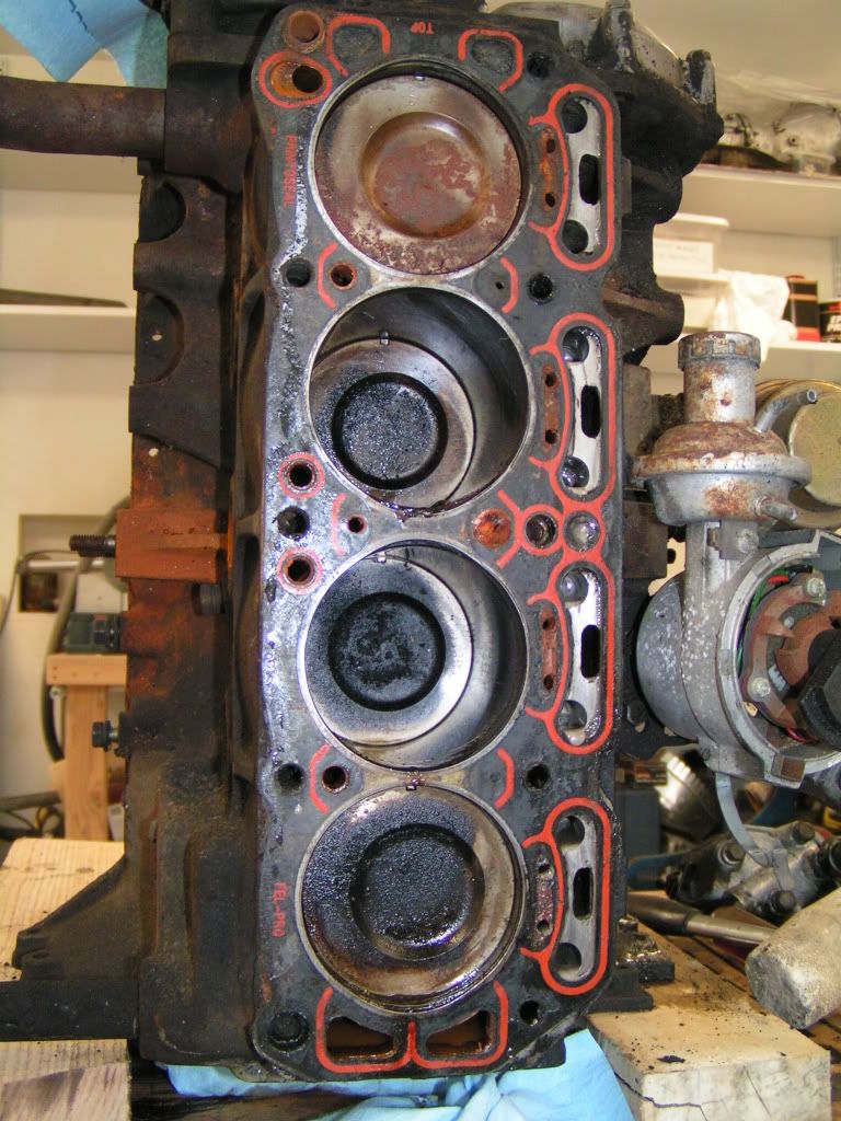

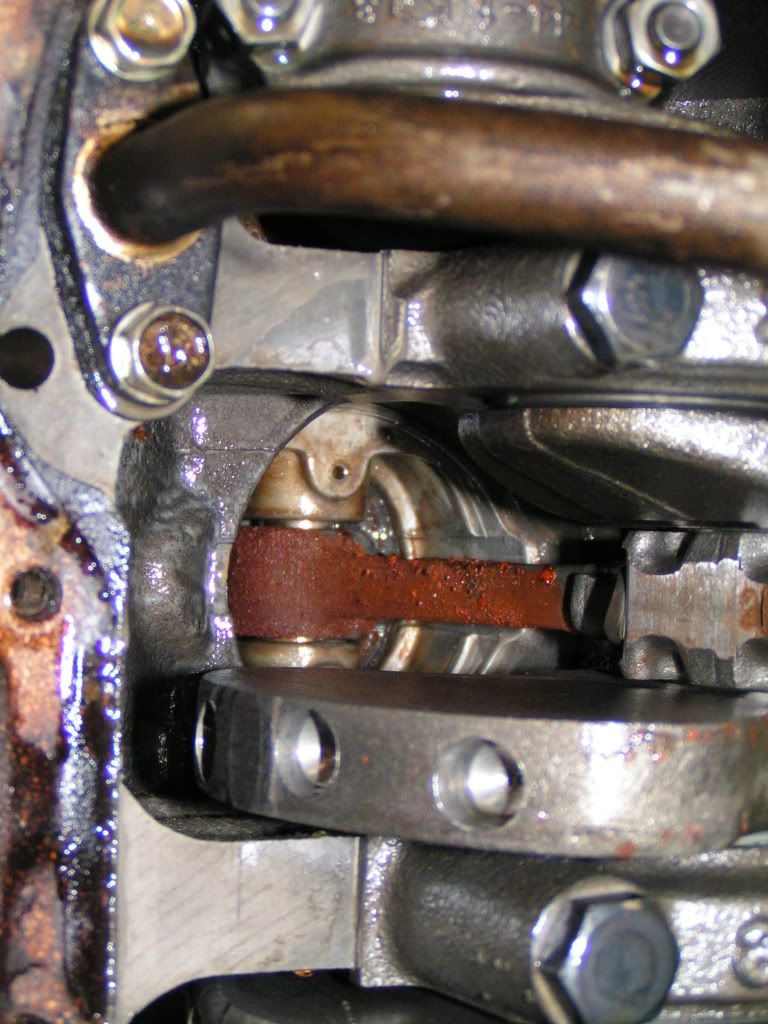

the tops of the pistons are stamped 0.75 which I've been told is .030 bored over, I dont want to get into buying replacement pistons that are bigger then these & I dont know if i can get them much bigger anyways & I dont know if the block can be bored anymore either. The blown head gasket & the rotted out freeze plug look to be the main issues, the surface rust on the sides of the rods I can clean off.
Here's what I'm hoping to do, dont want to spend a ton of $$ if I can avoid it but tell me if this is being too cheap or plain stupid. If I can clean up the block, hone/de-glaze the cylinders, do the main bearings & rings, leave the wrist pin bushings & cam
bearings alone, timing gear set, regrind cam (Delta Cam in Tacoma says they have 4 profiles for A series motors & its only $50 - $60 bucks) & resurface lifters & essentially reassemble.
I would love to avoid spending $500 in a machine shop for clean, mag check, bore & hone, etc... just clean & Mag is $140 & it just piles on from there. I did check the crank end play & its .005" at the #3 cap (middle), I'm winging it right now without a proper A15 book but I may go get one.

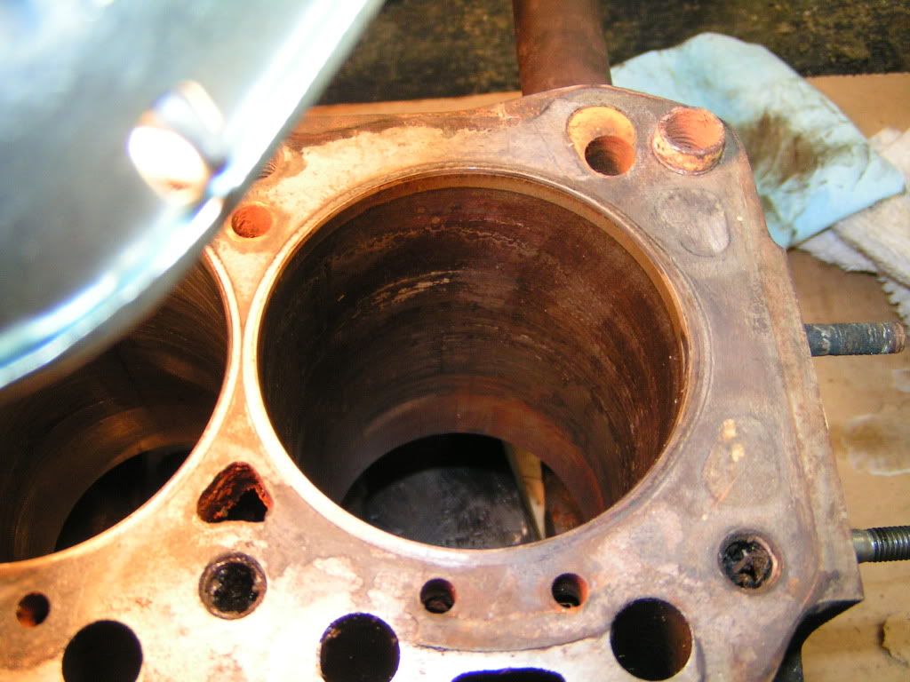

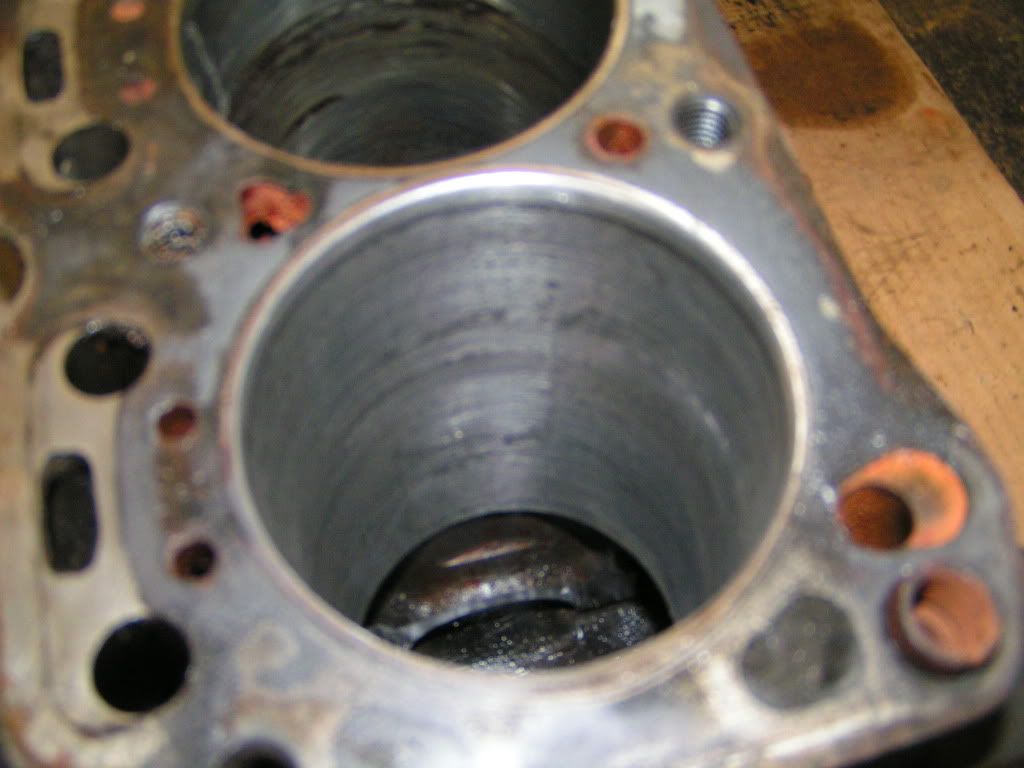

So throw me some opinions, am I going about this totally wrong or can it work out fine? My big concern is the surface rust in the #1 hole, I showed a before & an almost after pic (the de-glazer though a stone in the middle of it) & it seemed to be getting better, how perfect does a cylinder have to be for the rings to seat properly?

Given the fact you are going to get new rod/main bearings, you might as well get the crank linished. Typically it removes around 1/10,000 (1 tenth of one thousandth) or thereabouts, so won't have any real effect on bearing clearance, but it does tend to maximise bearing/crank life vs just replacing bearings. Based on local prices it wouldn't be enough to break the budget, I can only suspect it'd be similar elsewhere cost wise.
As far as honing goes - just give it a light 'dress up' and the important thing is to actually move the hone in and out (assuming you are using a normal handyman style electric drill which doesn't let you run it at low rpms) of the bore pretty darn quickly - as the rpms are usually so high that it makes it hard to get a suitable angle on the cross hatch pattern. It can help to duct or gaffer tape down an old head gasket to help prevent the hone angling out at the top of it's travel and leaving too much of a chamfer on the top of the bore. you don't really need much material removal at all - just a quick 'touch up' so to speak and the rings will bed in fine.
Probably goes without saying, but after honing, debris will (not might, not can, definitely -will-) lodge inside the cross hatch grooves. And scrubbing with solvent won't do the job. You really need (do it first with solvent) to get in there with a massively stiff nylon brush and hot soapy water. And clean the bores until the stage where you can run a clean lint free cloth through the bore, drag it up and down the bore and not get _any_ dirt/change in colour on the cloth. Stop short of that, and that debris ends up accelerating ring wear, and can cut into the longevity of a rebuild of this sort (and is probably where the idea of 're-ringing' an engine got a bad name and why so many think they need to bore to the next oversize). Looking at those bores though, there's no significant ridge, you'll do particularly well with just a quick hone!
These motors seem to be fairly indestructible, but just for peace of mind, I'd suggest getting someone to measure the con-rod big ends for size and ovality. I'd be particularly surprised if they were out of tolerance, but for the sake of about 5 minutes work to measure them, it can't hurt.
If you decide to clean the rods at all, use an up and down motion rather than across, if that makes sense (*not that a quick skim with a wire brush should damage them either way, mind you)
The head gasket itself doesn't look bad - I'm wondering if all the rust is purely because of where it was stored (possibly with a plug or two removed) and it got hit with rain a few times. If the gasket was bad, I'd be tempted to get the block decked (just minimally to ensure it was straight) but looking at the pics, I'd be inclined to leave it as is (just with a clean up of course)

Thanks for the input. You both confirmed what I thought in the first place, that most of the machine work isn't really necessary & a good cleanup should do the trick. I have a small auto/marine parts store (Edmonds Auto Parts) around the corner that has a small "semi"-machine shop, no real block work anymore but he's got a parts cleaner/washer that I can have him clean it up for about $60. Then I'm planning on knocking out the freeze plugs & start putting it back together.
polishing the cranks probably not a bad idea & checking the big ends as well, I'm planning on leaving the pins/bushings alone, figured I'd throw the pistons into the parts washer as well then scrub off the remaining surface rust. Hey, do I need to replace the oil pump, I know its probably good insurance.

I'd VERY storngly reccomend have the cylinder head pressure tested, and hardness checked. If the frost plug had rotted out, and the head gasket had blown, you've no way of knowing how hot that motors been. Becuase they are so hard to kill, they can run very hot for a very long time. This can bugger the heads, I've had more than my share that were cracked/and or lost their hardness. Also check the clearance in the ring grooves to see if they are inside usable tolerances. And also inspect the piston skirts for vertical lines. When a motor gets hot, the piston swells up in a bore and forces the oil out from between the bore walls and the piston skirt. If you get too much wear there, the piston it's really reusable. But even if you reuse parts that are past it, it should still go. These motors are pretty hardy old girls.
