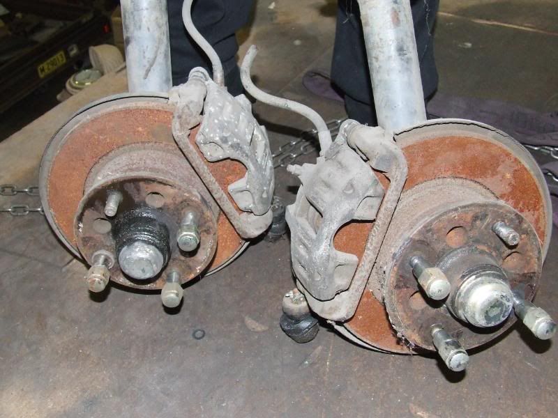

Ok guys need help to identify a set of struts
They have huge girlock calipers compared to the 1200 ones
Check the pic and give me your thoughts

They look to be stanza or 200b. Is the spring 100mm or 150mm. that should answer your question.

I reckon the spring is about 100mm
They were bolted into a 1200 coupe shell i bought
With no motor or box the front end sat very high, even with me and a mate standing in the engine bay combined weight about 200kg the front still had about 8 inchs between the guard and wheel

stanza for sure then ... you gotta cut down stanza struts to get them to fit in a 1200

aidaniel.. im pretty sure they are 200b as i have the exact same struts and brakes in my green 120y which i got from a 200b unless stanzas have the same sturts and brakes

they are stanza brakes, so most likely stanza struts too
need to measure the over all height of the strut tube to tell if they are stanza or modded 200b
