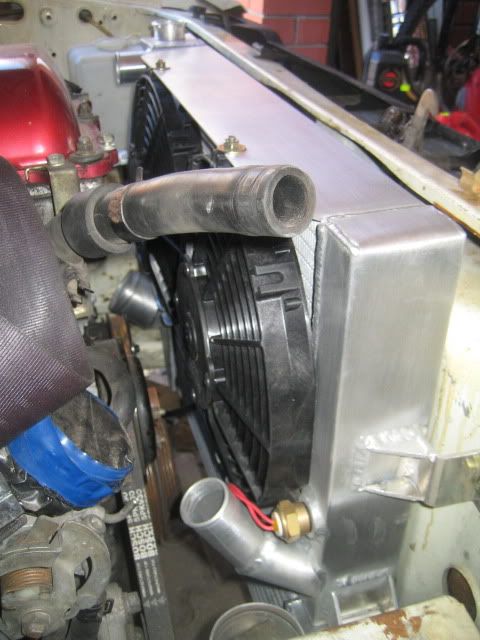

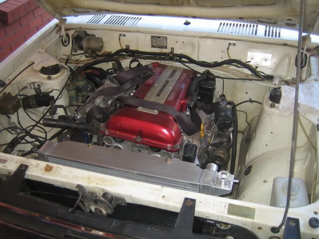

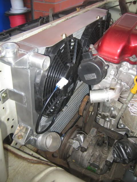

Have finally brought the 310 back to my place. I have a number of fiddly jobs to do, so no use having it 30mins away when I may only work on it for a few hrs at a time. Made quick work of cleaning the shed out, not having her out in the weather any more!
A few things have been done to her. Still working on the reinforcing of the tunnel, progress is slow with being busy at work, so have been getting the big jobs out the way first.. like radiator & intercooler.
Here's a front shot, A/C condensor will be the only thing visible through the grill ;) True sleeper style
Had issues with the fact I wanted A/C, hmmm, expected that... basically couldn't fit the radiator & IC behind each other if I wanted fans. Which being a street car is pretty much not an option. What I ended up with is the radiator on top of the IC. Fans will also have to run with the A/C as there is no room for another one! Would have liked a bigger core on the IC, but hopefully this will do the job. Will be setting up a water spray on to it, and see how things go. hopefully won't have to revisit this. Being a relatively standard motor it should be all good...
Also I have got myself a R31 LSD, so will be ripping the old diff out and in 3-4 weeks should be getting that back in. Woohoo, progress :)
