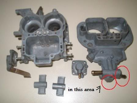

ok so my supercharger project is running a 32/36 weber and since i have put it back in the car it has started leaking fuel from the inlet area
im now running a electric fuel pump
and ideas or solutions would be apreciated

The brass barbed fittings are pushed into the alloy body. Over time they can become loose, leak and even fall out. You need to either remove them and epoxy them into place or better still tap the body for threaded barbed fittings. Go easy as there is not much material to work with.
Do it soon as petrol pumped onto a red hot exhaust =
Not one of Mr Webers better ideas
