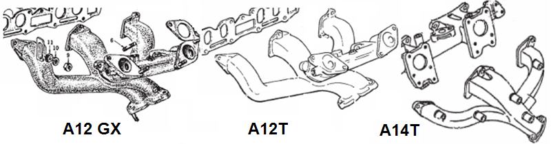

SUs are different. Made by Skinner's Union (S.U.) Fittings, linkage, and parts are all different. The general layout, bore size and mounting bolt pattern are exactly the same, except SUs generally have 4-bolts and most Datsun manifolds are 2-bolt. A four-bolt manifold with fit both brands of carby.
Aftermarket 4-bolt SU manifold for A12 engine:
Lynx D1000
Datsun Factory Twin-Hitachi Manifolds

The manifold in the picture is one of mine & is a Lynx D1000, made specifically for the A10 engine in the Datsun B10/1000 range.
It will fit & work on the 1200 & later small port A12 engines but has no provision for a PCV valve which the A12's need but which the A10 didn't use.
Lynx also made another version of this manifold that DID have PCV valve provision & this would be the one to get.
Some SU carb. models came with the two bolt mounting from memory & they would fit this manifold without difficulty.

A properly set up aftermarket SU system should perform almost as well, remembering that the GX manifold is water heated which is a big advantage on a cold winters morning in traffic.
