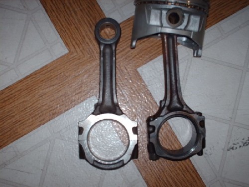

Good stuff Gary
Are your rods worked by any chance?
3 gsm is a fair bit out on the last one otherwise.
Looking at a14/5 rods they seem to be a good option if worked for an NA CA18de.
Rod comparisons....
best stocky rods are e15et but too long at 136.64mm c-c
jpg  ca18 rods.jpg (70.40 KB)
