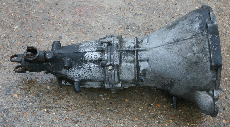

Do you think this is worth buying to put it behind and a14 with adaptation of course.
Is a dogleg gearbox from a datsun A10 violet.

Thats a 63 series the strongest of all Aseries boxes, ment to be roughly as strong as the t50. but it still requires work to fit in. needs Ither a custom clutch or redrilled flywheel to take Lseries cluth as it has a diferent spline, and you allso need a hydrolic clutch peddle set up, or modifie the box for a cable peddle

But this is from a L-Series engine.
