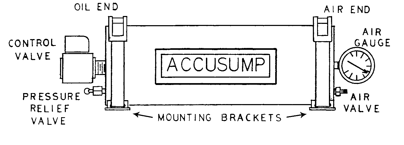

Any idea if the inside is just an empty vessel?
Here are the diagrams from their PDF instructions

looking at the diagram, it must have a dividing piston in it so the fire extinguisher idea wouldn't work. If it was a sealed cylinder its also unlikely that it would fill which blows my theory.

So for 150 usd I might as well buy it, however dont want to spend 75 usd for a manual lever
when perhaps the electronic switch would be best? however I cant tell if I need both switches
one for ignition and the other that senses the pressure level????
