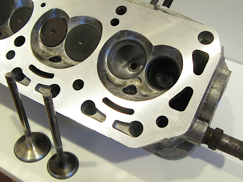

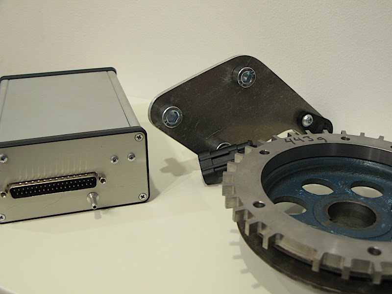

This is getting more interesting each day. I had another chat with my friend who owns the speedshop, he told me that they tried wetsleeves in the Volvo block for several times but they had big problems with the sleeves sinking and getting them to seal properly. They also tried sleeves and filled the block with concrete but as I wrote erarlier they ended up manufacturing own billet blocks, thatīs not a option for me. He also told me that I can get problems with blown headgaskets if I bore the A-block out to 79mm or more, there is not much area left between the cylinders and in a boosted engine it might be a problem. I will ask my engine-machinist if itīs possible to insert wet-sleeves and at what cost. I have never heard about "posting" but it sounds interesting. I will post a picture of my cylinderhead and my MS managament system and custom trigger-wheel.
A-series turbo cylinderhead with 38/33 valves
MS managament system and A-series 36-1 trigger-wheel
Marcus
