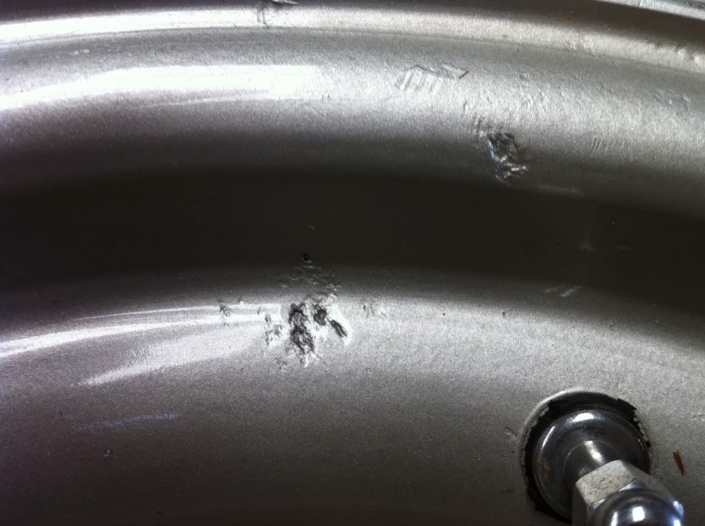

Hey I've got a set of Mk2's I'm looking to polish. The lips are currently painted silver but one rim has pitting on it Open in new window
should I still try and polish it. The pitting is gonna stand out way more once polished. Any idea what I can do to fix it or should just take the one wheel to the professionals to get it done. The other 3 wheels are fine.

get it welded, milled and re-polished...

Any one recommend where to get it welded and whatnot in adelaide? I'm thinking wheel works. 2 centers stripped 2 to go then painting centers then polishing lips

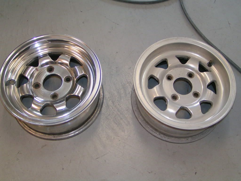

how bout these, cleaned off some of the road rash & buffed the c**p out of them. Takes some time.
before & after...
