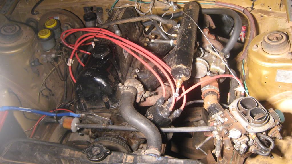

thedevilshands Posted on: 2010/10/31 1:47
#30 Re: Setting Up Turbo For Dummies
casey Posted on: 2010/10/31 2:28
there is a setup on an L20 using a DD webber forsale on Ozdat atm looks like it would work alright
