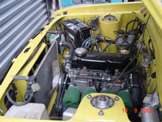

ddgonzal Posted on: 2004/1/10 8:06
If you fit a wider radiator, you do not need to cut the sheetmetal. When I put the B210 radiator in, I just let it overlap a bit. Similar to this picture:
quite thin but works quite well
