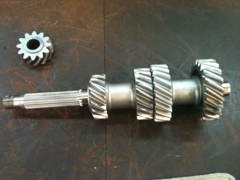

Re: Putting together a Nizmo gearbox. # No Synchro's allowed #
2008/3/15 3:30
Posts: 2742
Moving on to the layshaft, Our stuff, where possible will have a full removeable spline gearset. When sixe is a restriction we will incorperate an integral gear or 2. Spacers are made and in this particular case, the gears are designed to go on one way. It is a probably one of our first mass produced kits as apposed to the generic close ratio mods we used to be most known for.
There is a flange on the front to retain the Drop Gear (or referred to as the constant mesh gear) and it will be tensioned from the rear.
