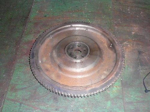

Got new valve springs today.(new on left standard on right)
I skimed some more off the flywheel. Its about 6.4kg now.
And A pic of my reground cam and my head.

I have buffed the casting marks off in the ports on the head
probley just leave it at that. webers fairly costly now(sold a good set a few years back and kicking myself now)maybe look at bike carbs?
valve springs measure 29.5mm od 22mm id 50mm high (free length) for outer and 22mm od 16.8 id 44mm high for inner spring.
