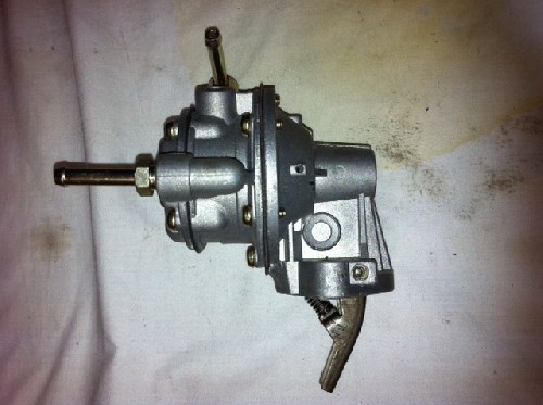

So i took the old one back and got this one, it also feels like it doesnt make contact with the cam.
What the duce? Those are the only listings the guy said he has.
jpg  photo(2).JPG (115.77 KB)
13160_4de874da36dca.jpg 640X478 px

The easy way to remember which pump fits which, the Long arm pumps suits the last revision of the A-series block [dizzy in the middle] and the short arm pump suits the early blocks [dizzy up front] this includes the A10 to my understanding.

Find another supplier. There is only one style of A14.

Well are you ready for the story?
I took this second pump back this arvo, now both pumps looked like they had been bolted up.
Fuel miser had 2 pump listings but one of the numbers was a goss pump.
Stay with me.......
When we looked in the photo book the 1st pump (goss) looked different to what was in the box, so the salesman looked it up and this box had been with them for 10 years and had been returned many times.
So we guessed it must be the wrong pump in the box and he has ordered a new one.
So heres hoping the one that will arrive monday is correct.
