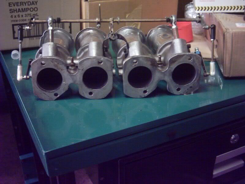

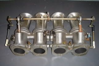

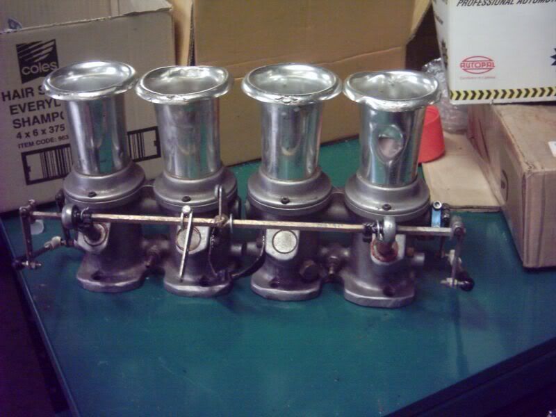

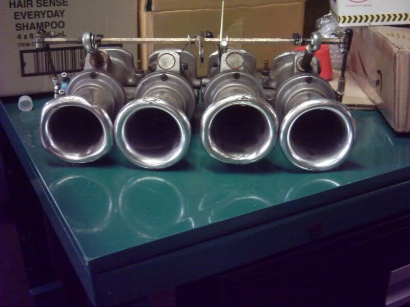

Posts: 2691
These are one set of mine (50mm)
