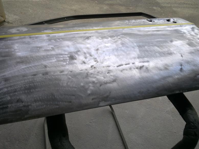

well been busy at work and other things finally got my doors all repaired,i done all the work on them myself with guidance from a good panel beater.Heat shrunk the big dints plucked out the smaller ones filed over then bog to get the lows out then 4 coaats of epoxy primer ready to carve back and high fill primer...3 full saturdays just on doors...

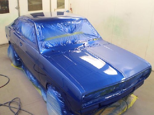

FINALLY IN COLOUR.Well after alot of heartache and pain the coupe is painted now chop it and flow coat it...
