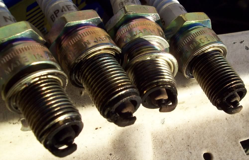

The plugs do not look oil fouled. The two outer ones look rich.
