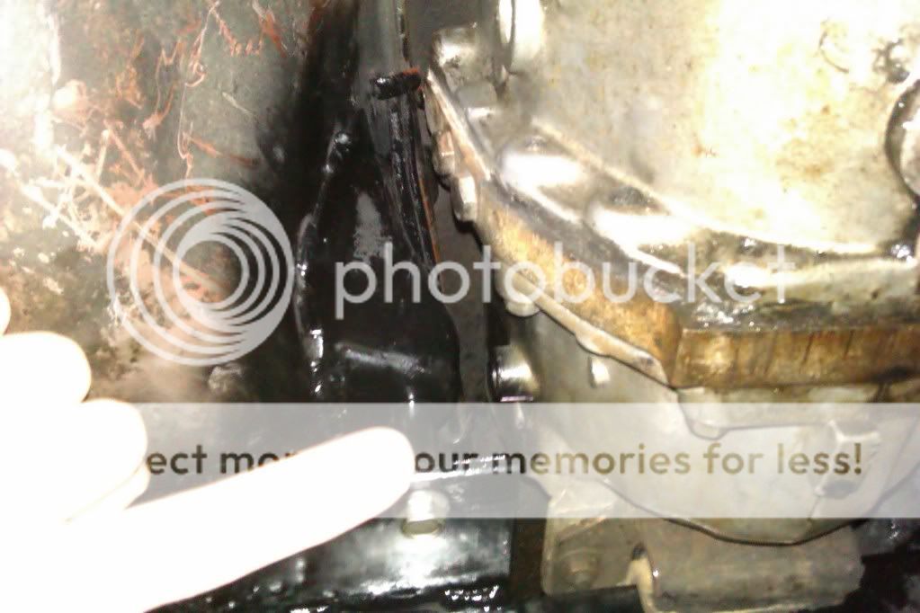

had the car on a hoist at a mechanics this morning, have organised for him to weld a second set of tunnel mounts in and modify the gearbox crossmember to suit (will be a H-shape) that way it will be all contained inside the tunnel to allow maximum exhaust room, and suit the engineers requests

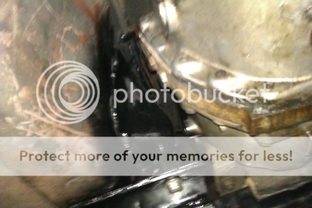

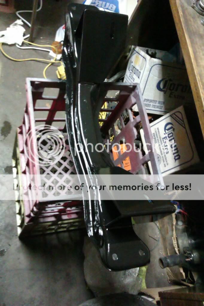

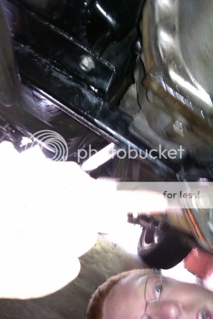

engine crossmember - done
gearbox crossmember - done

will try to get pics, tried to do gearbox crossmember already but need the car up on four stands to get anywhere near it.

tried to get gearbox x-member pic again today... no great success

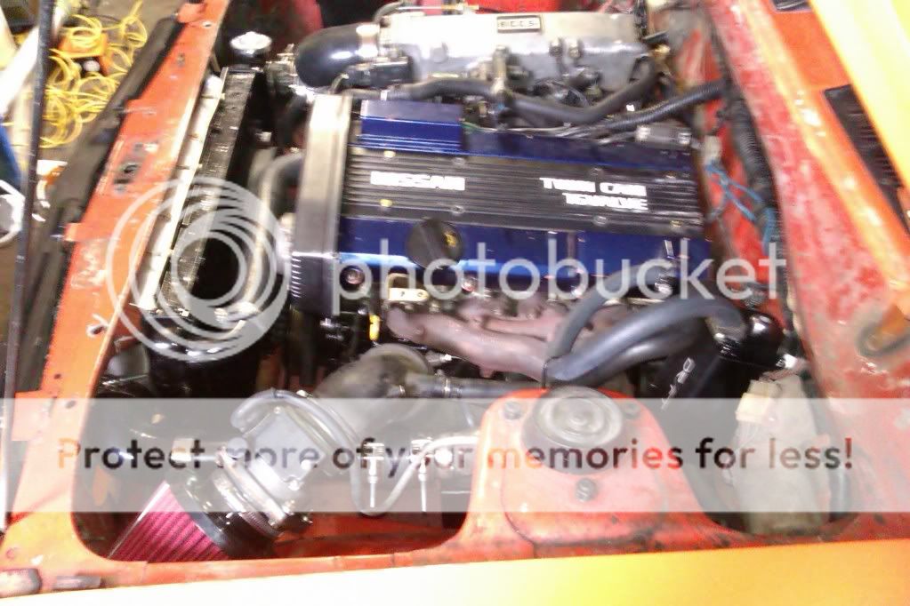

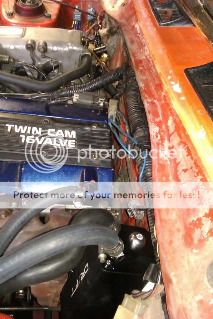

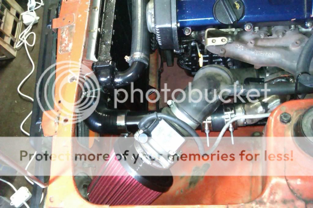

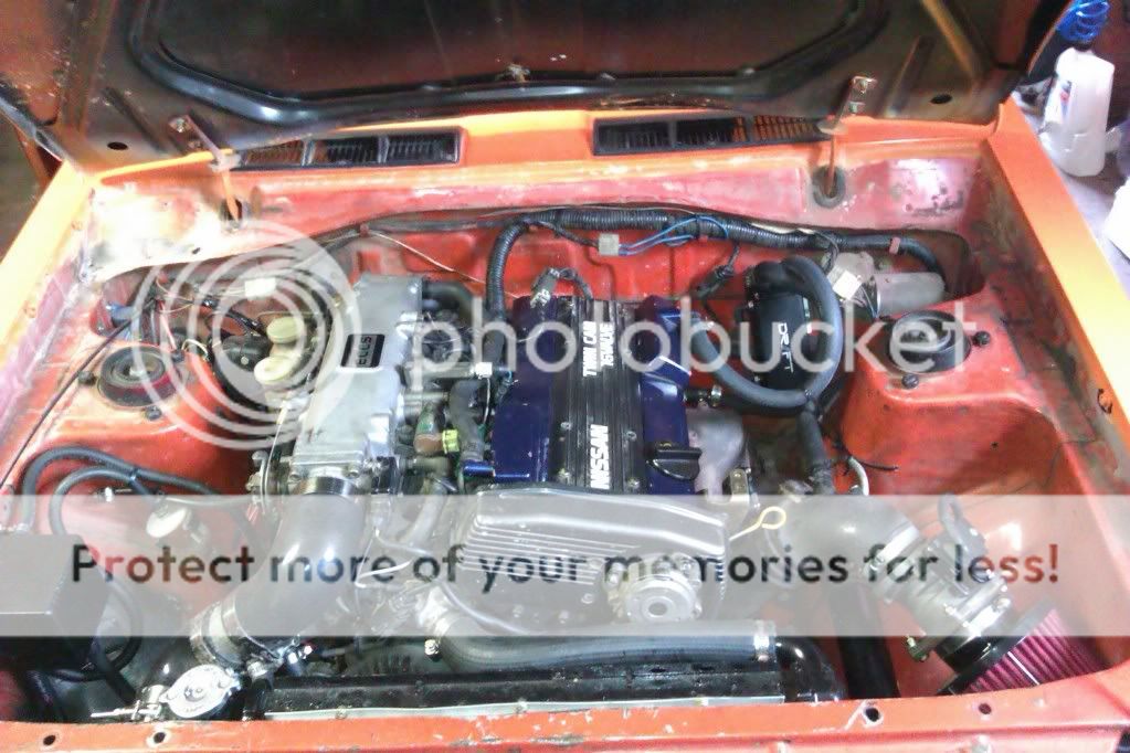

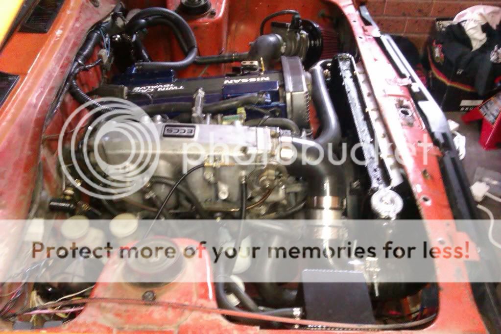

engine bay shots from today
ended up having a custm engine mount made
engine sits 35-40mm from firewall, with enough room for stock heater hose locations to be used
