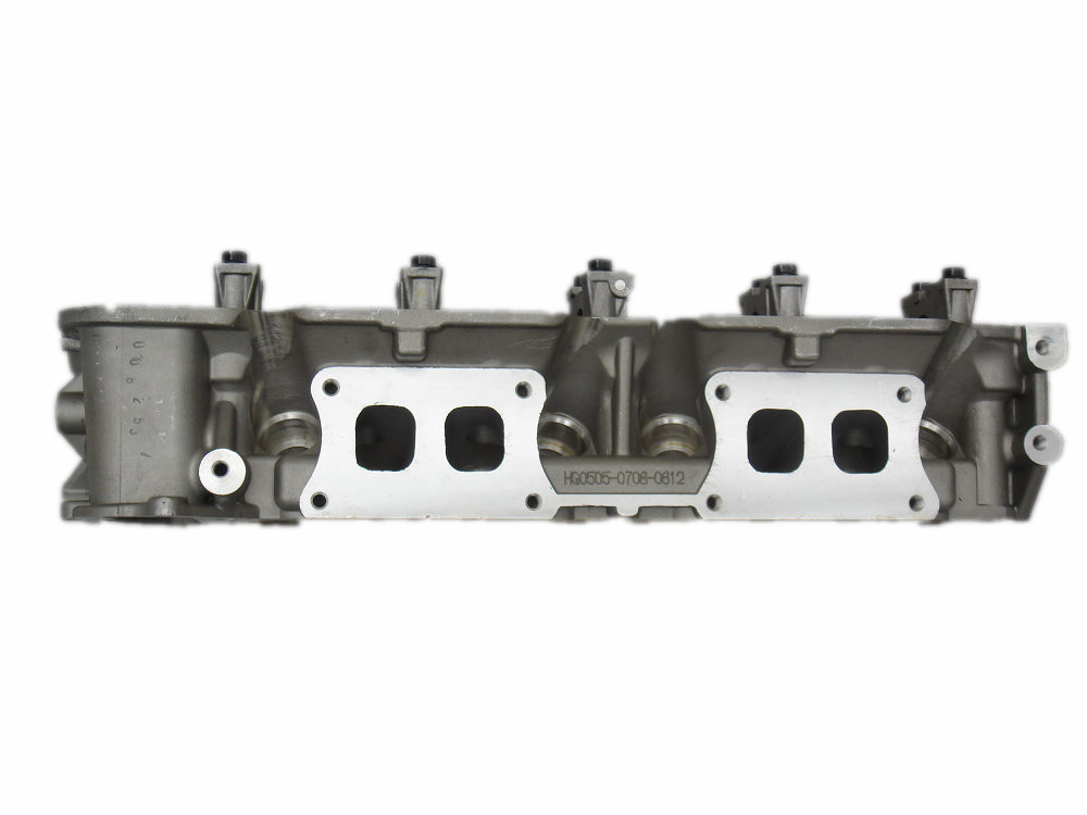

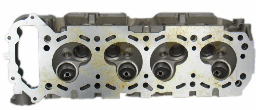

This is the NA20S head like the Z heads they will
allow the L16/18/20b engines to fit under most hoods,
They are 300 delivered to melbourne brand new castings.
Can get cheaper with more than 2. To complete head just
need tuliped SS valves and wrecker Z head rocker gear.
Camshaft all depends on use and machining to suit.
44mm inlets and 35mm ex stock (+2mm more possible).
