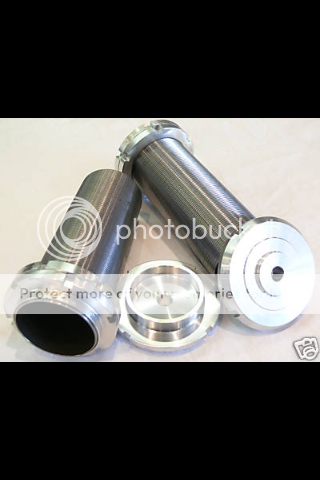

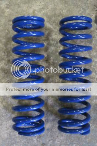

suppafattos pics
#17 Re: Eoi 2" or 51mm coilovers
supafatto Posted on: 2012/3/5 11:22
Thanks 1200rc and sorry to orange-1200
