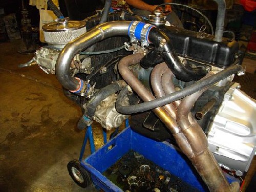

got bored over the last couple of days, so i can up with this, now all my rebuilds can be run at people choice.lol

That looks a bit like rogue's old set up?
What size is the engine?
What size is the blower? (Looks like an AMR?)
What size is the Holley? (Has the powervalve been externally referenced?)
And most importantly, what numbers does it make???

just a a12 #OOPS#er, oval port head, amr500, 350 holley,custom pipes, no HP figures(its not a dyno), only slapped it together to start engines,bit of running in,something to do, but works great, run engine for 20 mins no problems.

AMR500? looks like an AMR300 even though I own 2 of the AMR500
it looks small in that pic.
The inlet Y looks like an x-Wally manifold, funny looking thing :)
Nice looking headers! straight out no restriction looks like a speedway version

sorry fellas its appears to be a amr-300, thanks D for the info. i bought the engine package the other day, don't know whats done to engine, all ac's came in a box, slapped it all together ,built a stand,to my surprise, sounds unbelievably awesome,now time to finish stand,make control panel,battery/fuel tank mount etc
