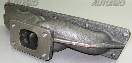

Advantage of 4 valves over 2 is around 30% more valve area
The complexity & cost required to gain 30% more flow can be surpassed and be cheaper with a good cast turbo manifold, good inlet & correct fueling on an 2 valver A series.

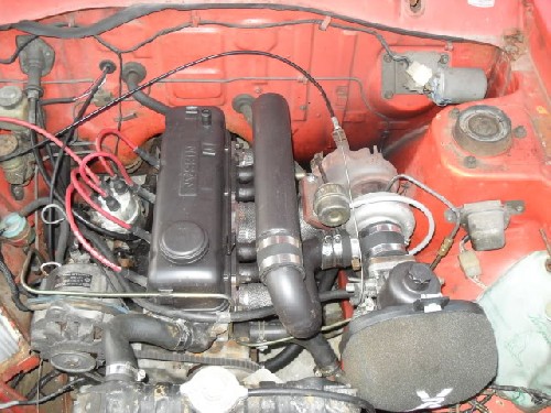

D, I have been down the turbo A series route already actually. It will definatley be N/A.
Have done quite a bit of reading on here on DOHC conversions etc. Should have a GA16 head by the end of the week.
Here was my turbo A series I built up-the car and motor has since been turned into a racecar!
