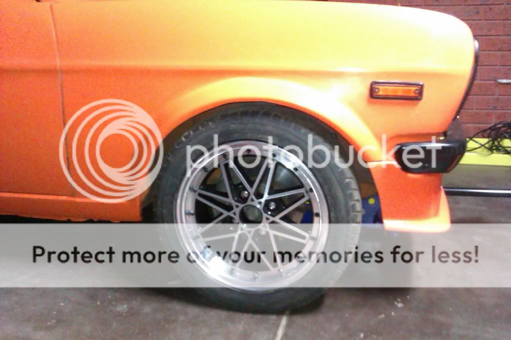

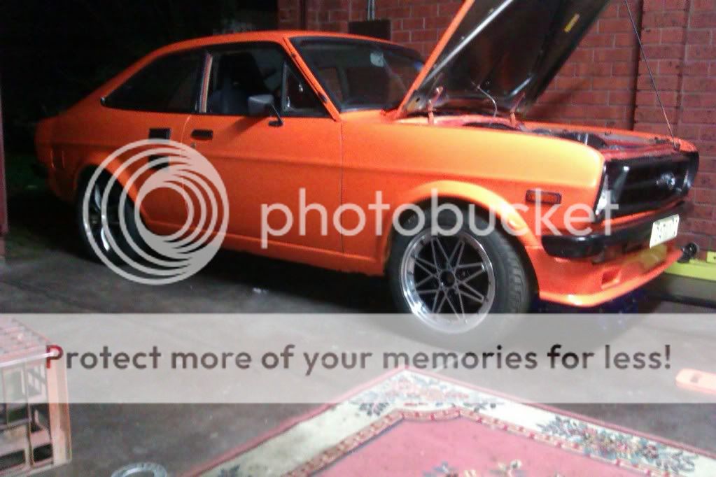

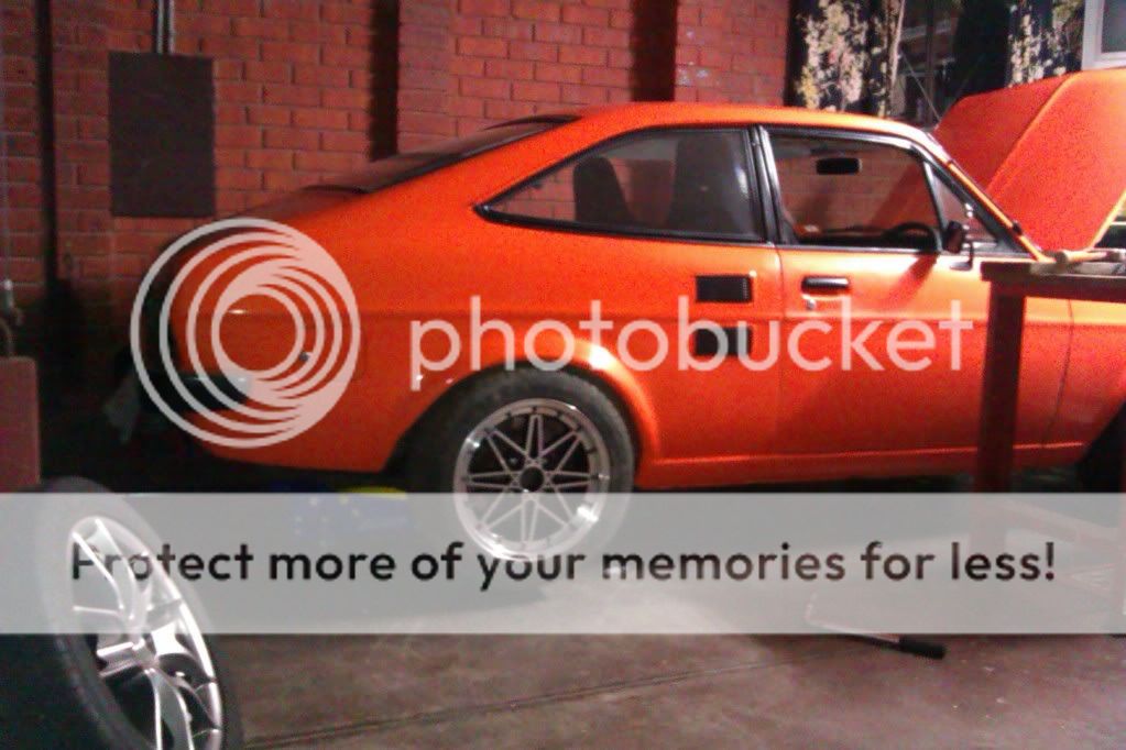

got an old tyre fitted to one of my equip's today to test fitment
they sit too wide on the rear but are perfect on the front, i'm going to get some quotes to shorten my 190 back to the original diff width so i can fit them on the rear (any suggested shops?)

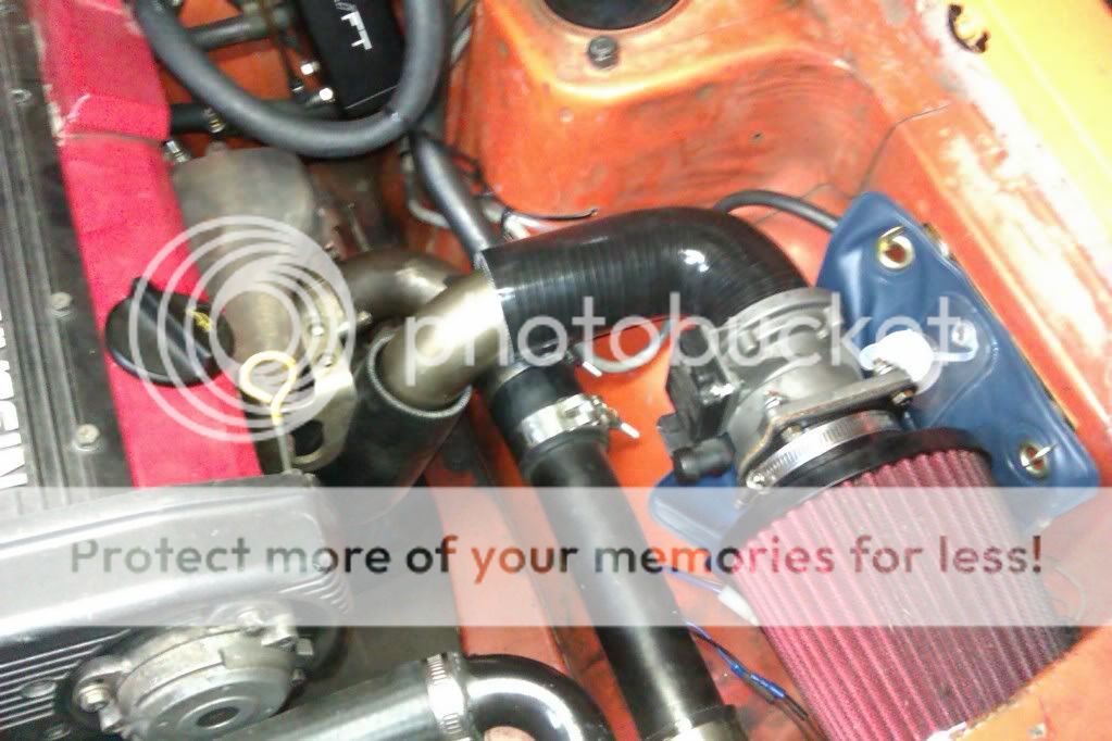

fabricating bits and pieces to mount the air filter straight along guard, then need to make a bracket to support the weight of it

Yay progress. Wheels look good maybe easier making bigger flares than shortening diff
How wides to wide?
Air filter looks good too. Maybe use some of that silicon on my runners for the coolant hose in that pic too.

Re: 1200RallyCar's - CA18DET 1200 coupe
What size tyre 195 55?
Try 185 45?
Posted on: 2012/5/29 13:29
2002/3/20 3:40
From Melbourne, Australia
Posts: 8221
they need to come in at least 30mm to not munch flares, the current diff is 45mm per side wider
currently 195/50 tyres, with 45mm shorten of diff (back to standard) i could run 205 tyres on rear i think
Non shortened diff makes replacing them easier and cheaper
