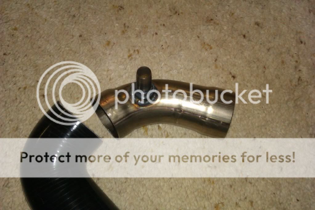

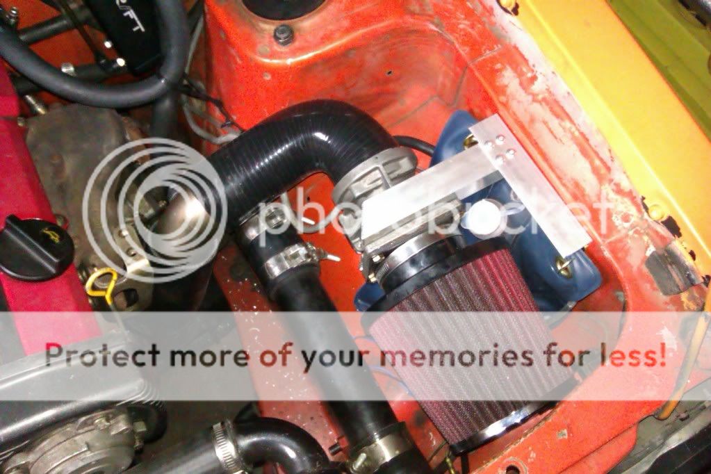

been mucking around with the air intake, just because using the silvia hose it sat on a funny angle and the hose had a kink
just used an exhaust offcut from exhaust place, got him to weld a steel hose barb from bearing wholesalers on and flare the ends to 60mm
then used some angle aluminium to make a bracket that reached around the water squirter bag,
two 90 degree silicone hoses from UK (cause they actually stock 60mm) and i'm waiting on hose clamps that supafatto has for me

-Finished off the air filter setup with clamps, thanks supafatto
-Wired thermo fan to control by temp sensor
-Made a shortened cig lighter which doubles as a peep hole to check the cltch resevoir level
-Made a fake choke cable
-Rewired the power to coils around the back of the stock tacho, hopefully that will work (was able to fit 25amp wire past back of tacho through the standard fitting, which is heaps over the 15amp fuse)
So i will have a complete stock looking dash after all this (with everything working) only change being a modern Stereo head unit, which is the look i wanted
