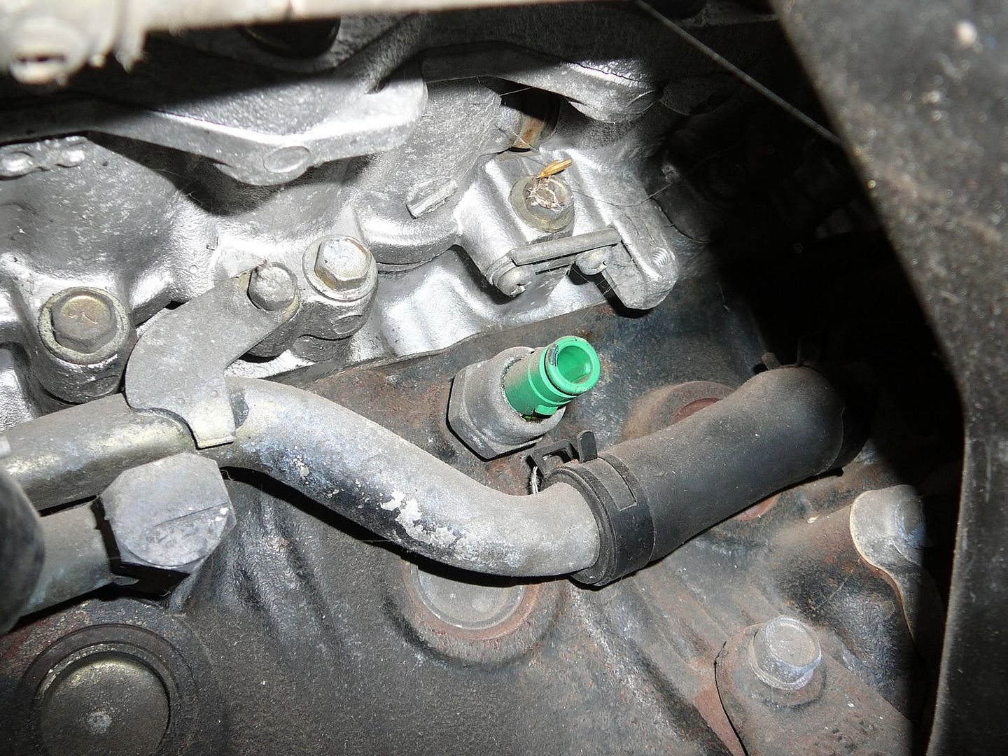

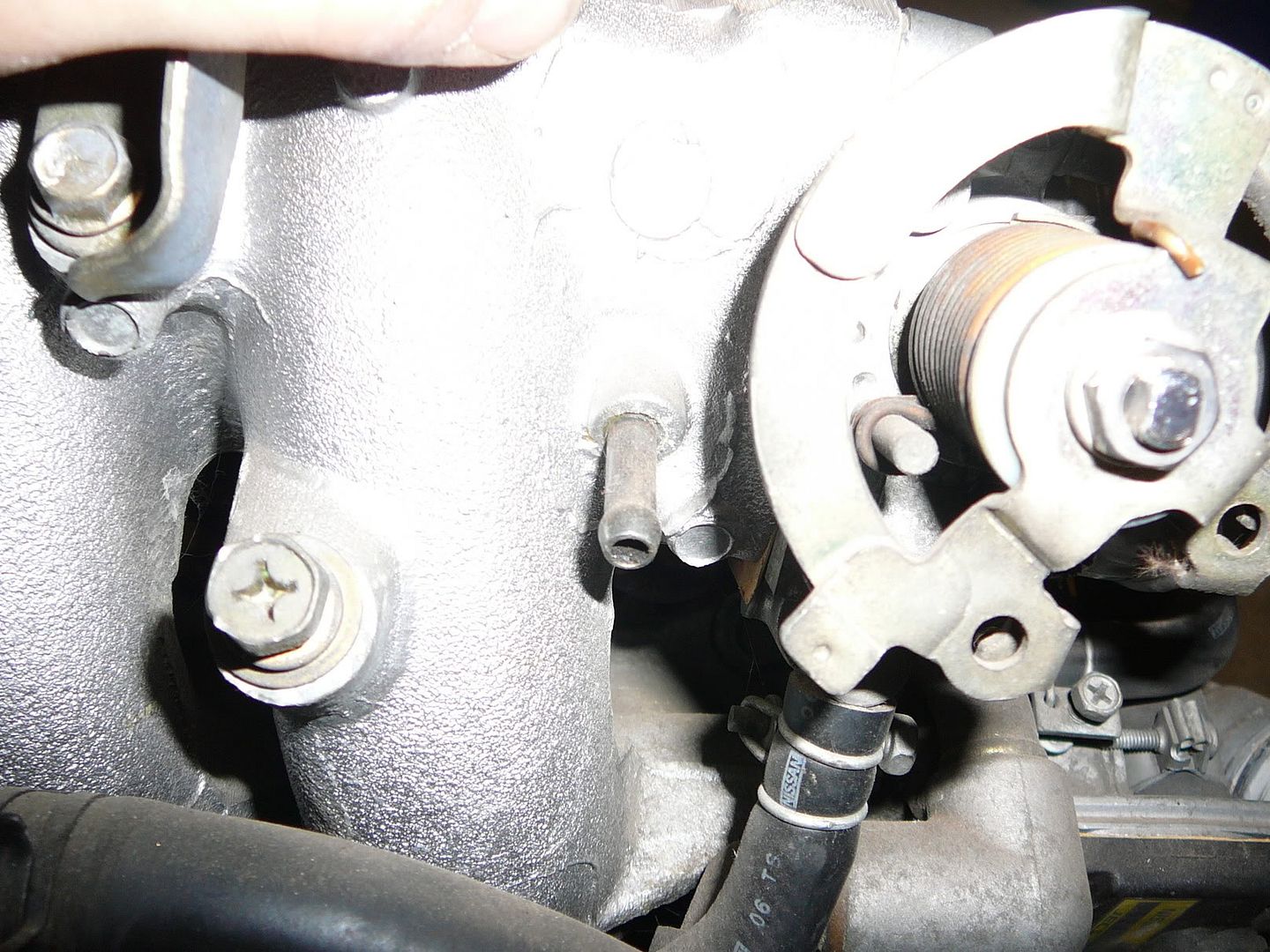

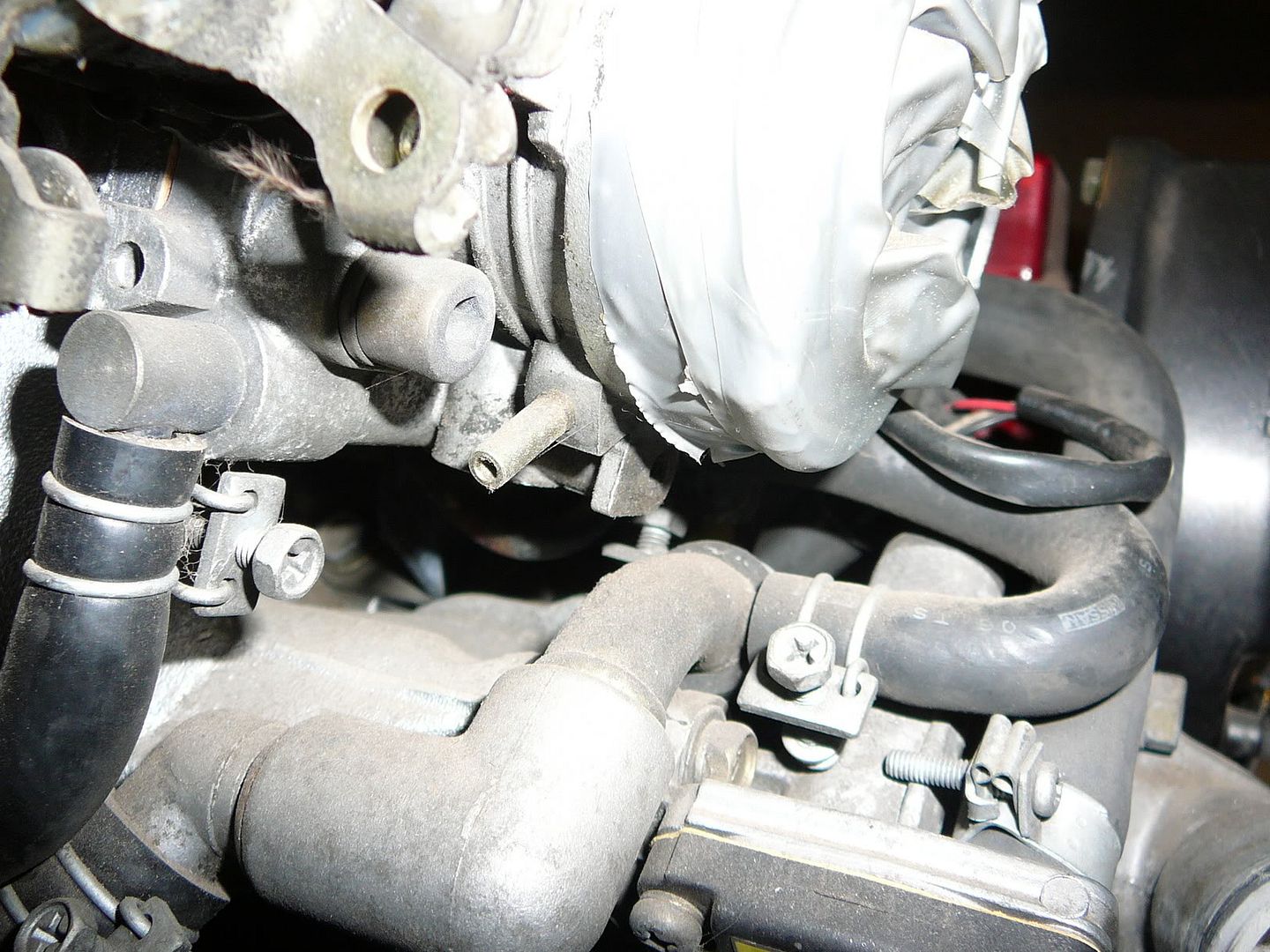

can any you guys with CA18 turbo conversion tell me what i should do with each fitting's/plug's, and what they do?
thanks fella's

First pic is knock sensor

Are you talking about the green pipe, ,sorry Ive had nothing to do with the engines before, can I block off any of them or will it effect the engine in anyway?

First is knock sensor, you can run without it but it is Advisable to use it . Next 2 are vacuum ports, you can block them off but you will probably need them for your fuel pressure reg and intake butterfly's. Next is a neutral switch, not required. The last is your reverse light switch.

Thanks Matt, with the knock sensor is there anything on wiki to see'n read up on about this, id like to know where the go to?,
there 2 plugs on the box, is the front or the rear your talking about!
