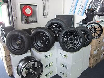

are the black wheels in the photo sorta what your after? you can buy them here in aus in dato stud pattern
Posted on: 2012/6/11 1:12

sweet. yeah it looks like you can reverse them easy enough (at home even)
