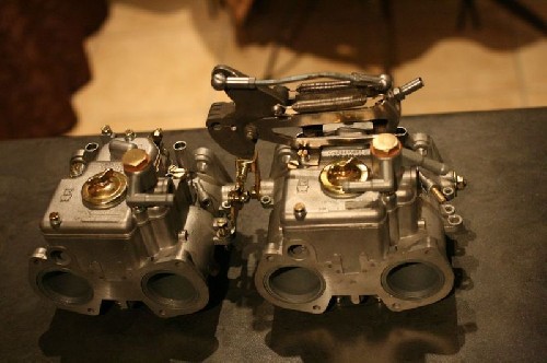

Hi does anyone have some ideas for a normally aspirated a14..I already got some twin webers dceo28 with intake manifold but not sure on the correct jet sizing..was thinking on gasflow and skimming the head but my friend has an a15 head that he's selling so i was thinking on buying it and tuning that one,would the a15 head make a difference??and the valve springs,can I keep it standard or should I get other??and cam degree??plz i'm a newbie to tuning motors..any suggestions would be appreciated..aiming for 15sec 1/4 mile

DCOE 28s? Never heard of ones that small. We normally run DCOE 40s on the A-series.
A15 uses A14 cylinder heads. No difference. There are several different design A14/A15 heads though. Which one do you have?
Skimming the head to go from 9:1 to 10:1 will give about 3% more power. That is 2hp.
Yes, if you want to rev the engine higher than 6000 RPM, get double-valve springs. For that you will need DCOE 40s, and a better camshaft. Better to swap in the entire A15, and use a GX camshaft (256/256 degrees). Most A14 and some A15s use 248/256. Later A15 uses a very mild cam.
