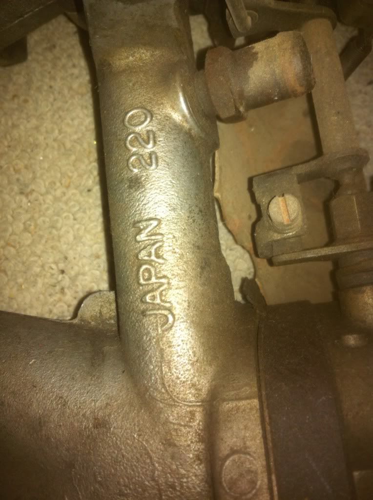

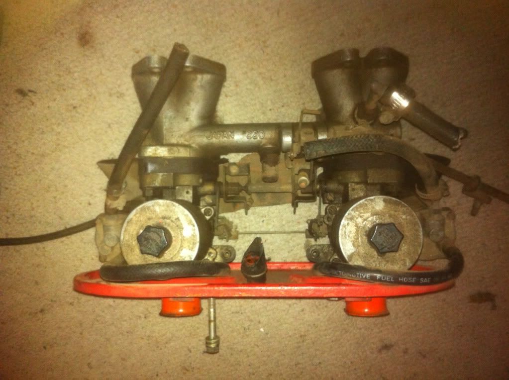

Hey i was just wondering if i could put an a14, or a15 into a stock a12, if so what would i need to modify for it to work properly, i also want to put this carby on it and i don't know what its called if people could help me with that also.
http://i1240.photobucket.com/albums/g ... eMexican69er/IMG_0265.jpg
http://i1240.photobucket.com/albums/g ... eMexican69er/IMG_0266.jpg
http://i1240.photobucket.com/albums/g ... eMexican69er/IMG_0268.jpg
The Japan 220 is prob where and the number of when it came of the line, but its there anyway.
Cheers

Aren't they L series carbs ?
In which case you need a new manifold anyway
So find that first... then worry about the head

Stock1200Ute1 Posted on: 2012/7/24 11:16
looks like twin SU's off of an L series engine.

ddgonzal Posted on: 2012/7/24 19:05
Applied Model Code 220 is Datsun 510 SSS (L16 engine)
is it possible to get an Aseries manifold for it and then put it onto an a12?
Yes, those carburetors will bolt to an A12GX manifold. But then you need a GX cylinder head, as the manifold ports are larger than A14 or A15 ports.
The SSS carburetors are the same as GX carburetors, only the needle jet and dome spring differ. The SSS is slightly leaner than the GX.

ddgonzal Posted on: 2012/7/25 0:54
Those carburetors are Hitachi sidedraughts, and are a licensed version of the british S.U. (Skinner's Union) carburettors, though the Hitachis are different in various ways.
The ones in this photo appear to be Hitachi HJL38 models. 38 mm throttle bores (1.5 inch). They were used in Japan and UK markets, also South Africa and other places.
