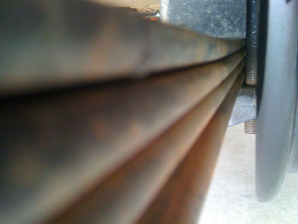

I got my rims today definitely need spacers on the front possibly 10-15mm or more and maybe 5mm on the rear ill post up some pics tell me what use think.
The last few show the clearance between the rim and leafs roughly a finger space or about 11mm

You only need 4mm space between rim and leaf spring. They don't move relative to each other.
The tire is a different matter. It flexes under cornering and moves up/down. Some say you need more than 4mm spacing for the tire.

so im ok with the back then i might buy some 15 mm spacers for the front then see how they go im gana go with a 185-55-15 tyre as well they will fit fine under the front guards??
