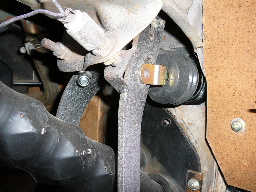

Hey I brought a maddat brake booster to put into my datsun 1200 ute and the original brake pedal dosnt fit onto shaft cause the haft I to long what have people used any hep would b great cheers

Did you buy the kit from maddat? Because he supplies the new break peddle

Yeh mate brought the hole thing from him no pedal

i never had any problem fitting over the pedal(as seen by pic), only thing i had to do was make a new hole for pin to hold it on....

I bought the booster/clutch master bracket expecting it all to fit with 120y booster but i had no chance of it working without using the original spacer.

i had to do exactly what hotrocket has said.

Do u have to adjust the rod cause srsly it's way to long and if I push the shaft in it would be pusshing the breaks on correct

Hi fellas im pretty shore that the pedal u get with the kit is for the clutch.

The peddle is for the clutch
The brake peddle hole does need relocating
The fitting instructions has all this info on it!

I would not adjust the push rod because it will be set with the right clearance to the master cylinder. I can see in the photo that the stop light switch is holding the pedal down, move it away from the pedal and then you should get plenty or extra room. Let me know how this goes
