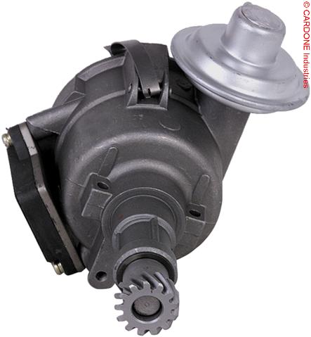

Hi DD if I bought this http://www.rockauto.com/catalog/x,carcode,1208821,parttype,7108
would I still need to run the ballast resistor and coil? i.e. could I keep them in place and not change them over or would i need a new coil to suit?
the weights and curves are right for a stock a12 aren't they?

This is the Datsun B310 electronic distributor RockAuto.com $163 USD + shipping
It needs in addition to that unit:
* Cap & Rotor
* You can use it with the stock coil & resistor (for low-energy output)
* Or use an early Pulsar/Bluebird coil without a resistor (for high-energy)
The weights and curves from a stock A12 distributor are not right for performance. You should calibrate every distributor if you want maximum performance. Otherwise, yes it will run as-is no problems. Set the static initial timing to 5 degrees BTDC for USA distributors, as they have MORE advance than AUS distributors (which are set to 7 degrees initial). Likely you could go up to 7 or 9 degrees, but it depends on the tolerance of the individual distributor and your specific engine. In other words, don't let it ping.

but the 310 is a direct swap using a stock setup and then could eventually replace the coil.. would it be more reliable? but I'd love to know what new coil part number I'd need to buy for the 310 swap if possible?

310? Do you mean B310? Because Datsun 310 is something else. Read about the B310 electronic ignition parts here, including Cap part number: B310 Electronic Distributor Swap
