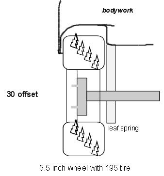

13" wheels from B210 or 510/610/710 fit without any modifications. The are 13x4 +30 offset or 13x4.5 +30 or 13x5 +25 offset.
With 13 x 5.5" an offset of + 19 to +30 is needed for zero modifications and normal tires. Stretched tires could go with a little less offset.
5.5" +30
7" +30
with this dimensions i can put a tire with 175mm 60?

Yes, a 175-width tire is for 4.5 to 6" wheels per tire manufacturer. If you put it on a 7" rim that is considered a "stretched" tire and is not warranteed.
