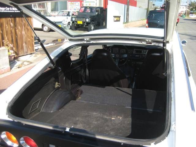

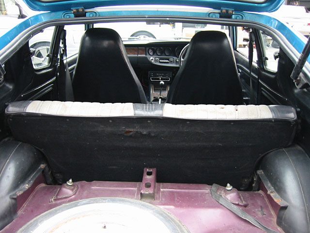

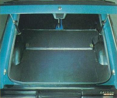

that's even easier! all the brackets on the wheel arches and around the back are for the false floor they had, which is level with the rear seat folded down. You can easily make a new false floor from plywood with a jigsaw if yours is missing or badly damaged, and glue some carpet to that. plus a couple of hinges for the center panel that lifts up for access to the spare tyre etc. That had a hook that went around the LH gas strut to holds it open.

ddgonzal wrote:
In the last picture I notice a metallic protrusion on the left side. Just above the left wheel arch. What is that for?
