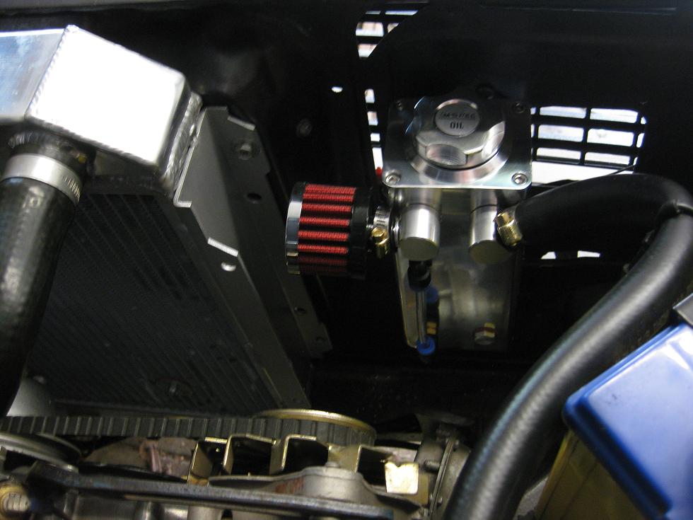

Just fitted an oil catch can to the engine due to a recent problem with a random cloud (big cloud) of white smoke behind the car when pushing hard.
My crankcase breather was plumbed to one inlet manifold runner and vacuum was reduced on that carby barrel much like an air leak. I found that the PCV valve had fallen apart inside upon further investigation, discussing this with another member we came to the conclusion that the plumbing was the cause, oil thrown up at high revs getting sucked up by the carby and burnt.
All seems good so far, I'll update if it happens again.

Catch can fitted, might plumb it into the airbox one day.
