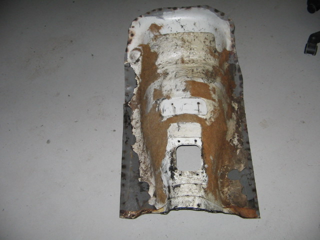

Todays job. Cut Auto tunnel out of old Coupe sticking to the original seam, except near seat rails of course as Auto tunnel actually goes back past the seat rails, and 1/3rd the way into rear floor. Then cleaned off remaining bit of floor pan and firewall by carefully grinding the spot welds down, then flapper disc on grinder. Cleaned off 40ish years of grease and dirt on under side. Now to remove old mounts and linkage guide thingy and then on to other side removing old tar and crap so we have a nice clean slate to fit to ute.
P.S I've changed me mind goin L series in wagon and CA and stumpy in Ute now.

keep the mounts to reweld back on later. Gives a nice factory finish to the x member location for gear box.
Engineer liked it on mine.

Going to use a maddat type crossmember man, plus who said anything about engineers ? this thing is a limited edition from factory CA18 manual The previous owner never told me which factory though

Lol ill keep old stock mounts

Kept the old stock mounts and welded in solid spacers to make them longer, but each to his/her own
