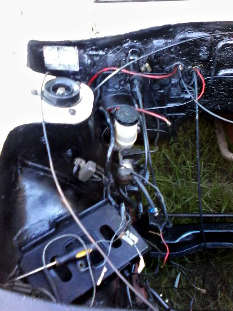

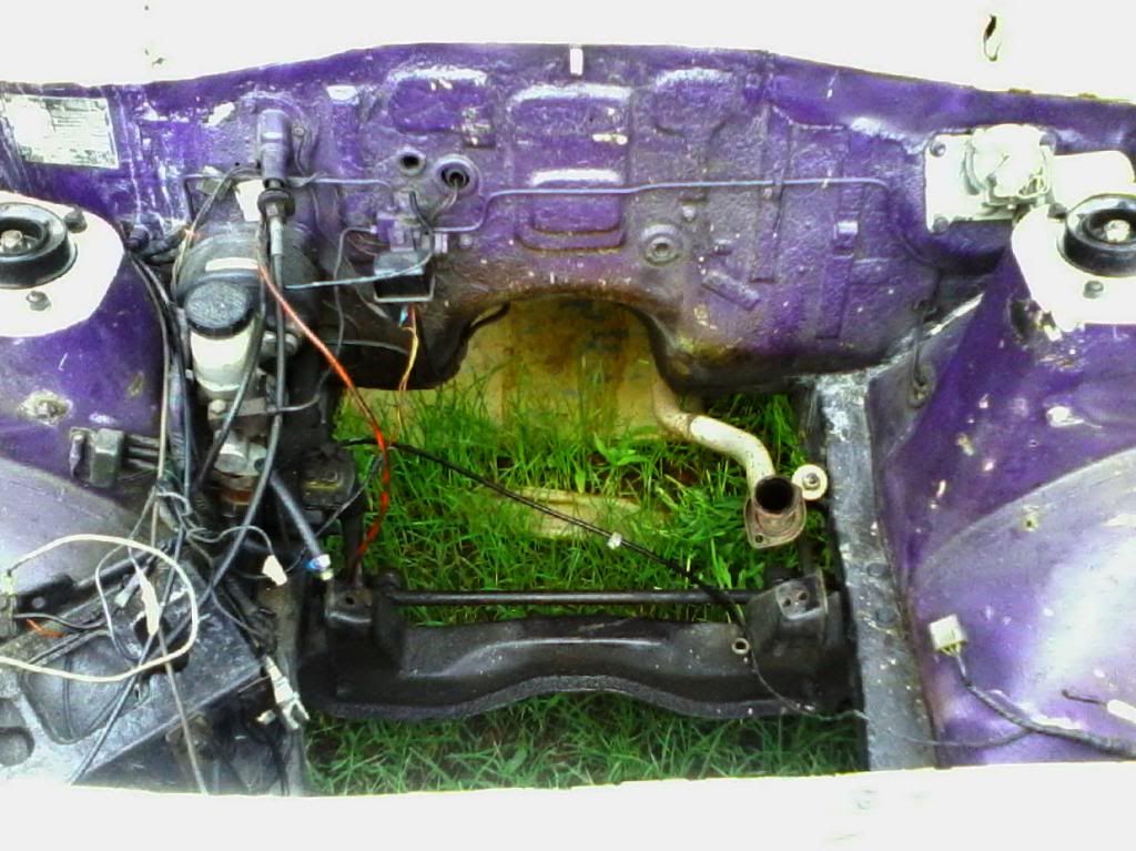

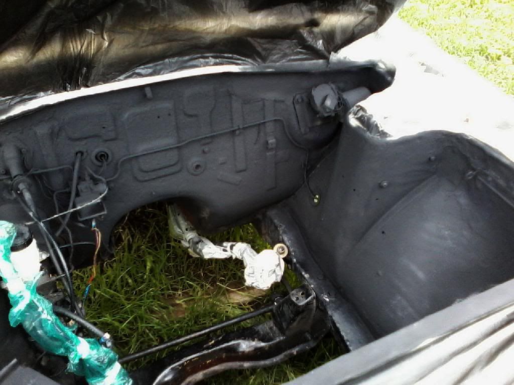

Update

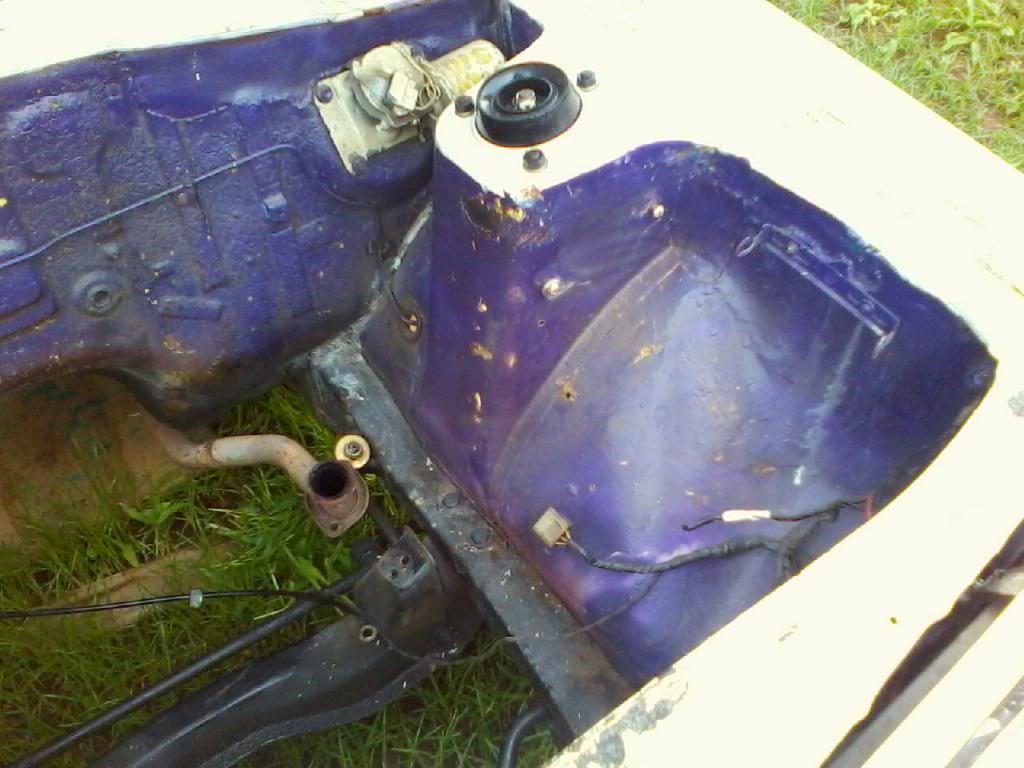

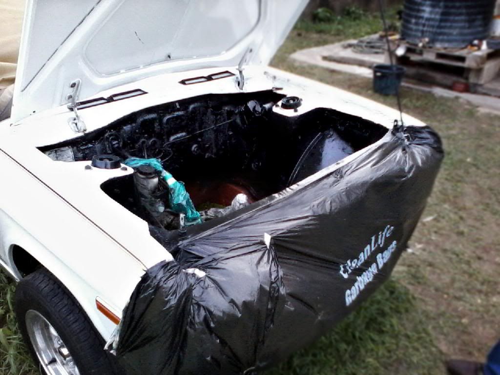

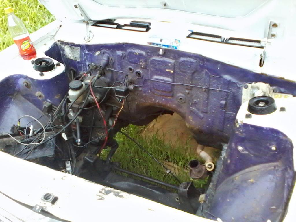

Striped the engine bay washed it nice an grease free today.My fingers are all worn out from all the sanding but its all for the looks!i'm considering Changing the colour.
The weather was very cold and wet today so i couldn't have painted tomorrow i will be tidying up some more and taping up the wires.Here are some pics !

Good work, go a lighter colors, easier to spot leaks etc

Yes thanks for that tip

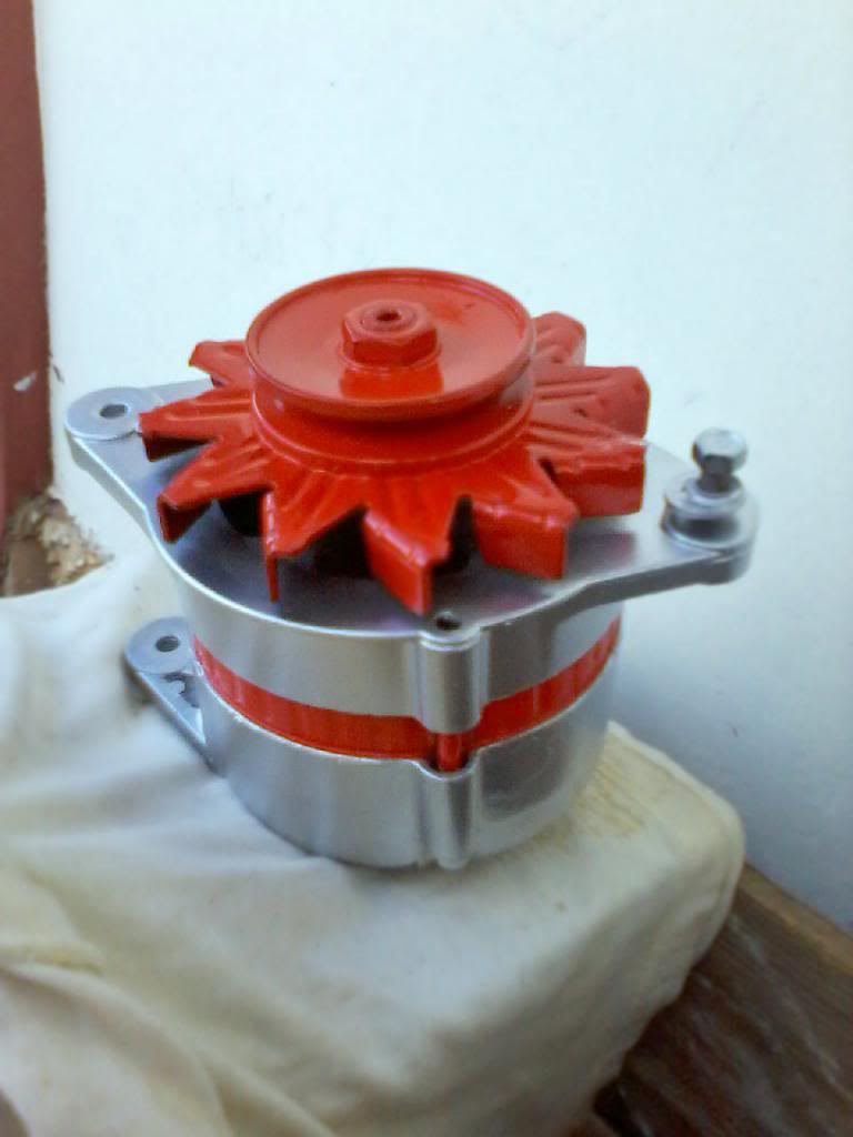

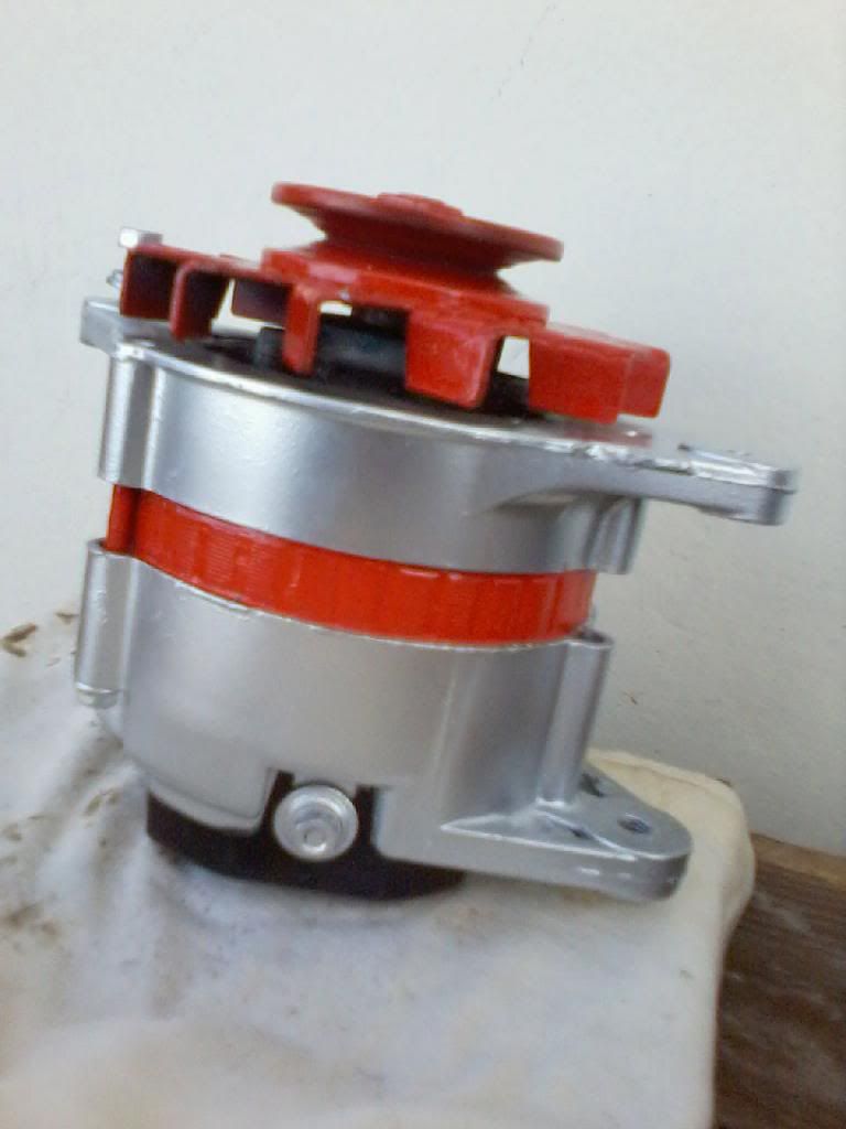

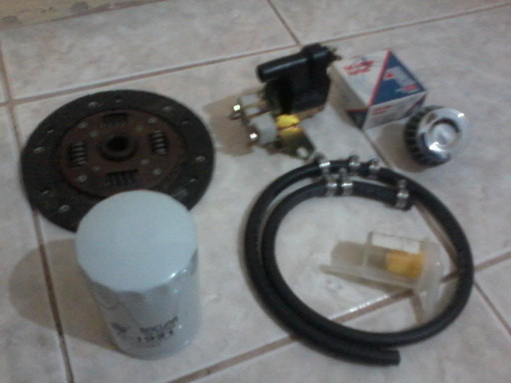

Clean more of my parts and organized some!

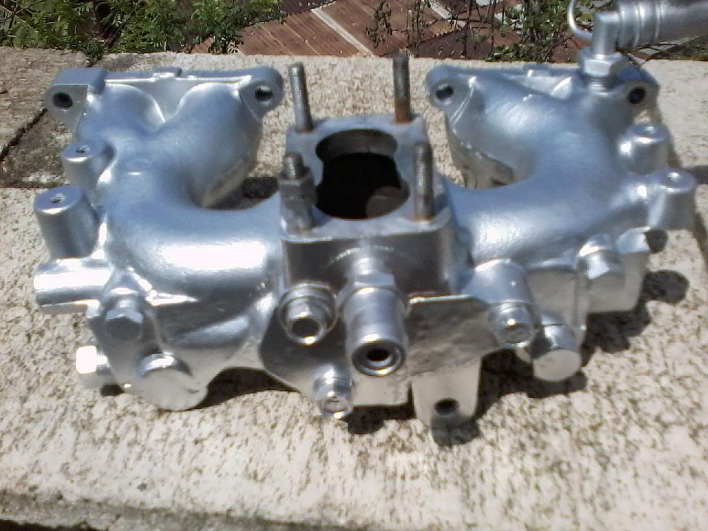

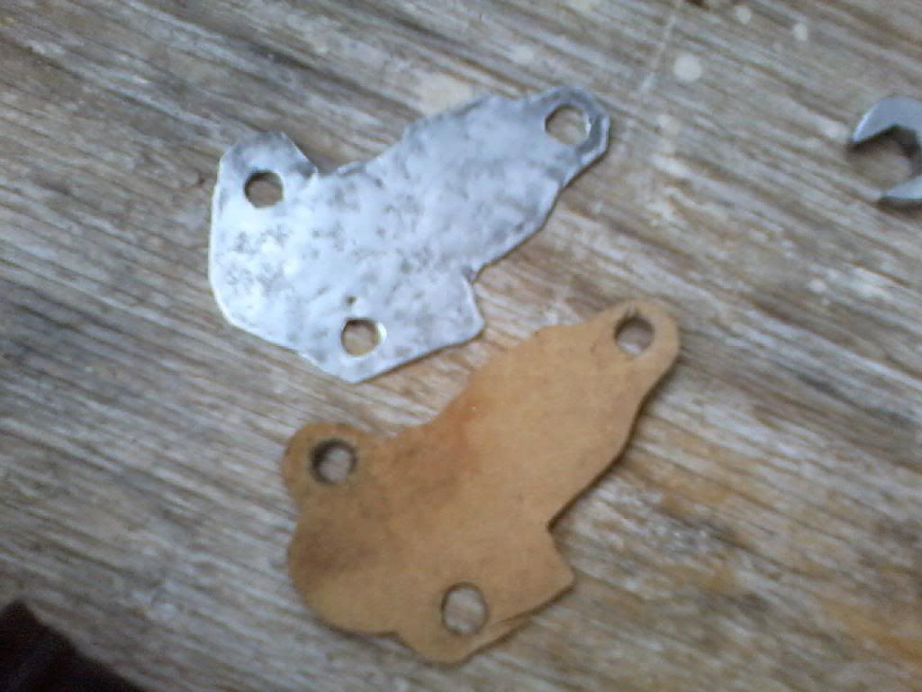

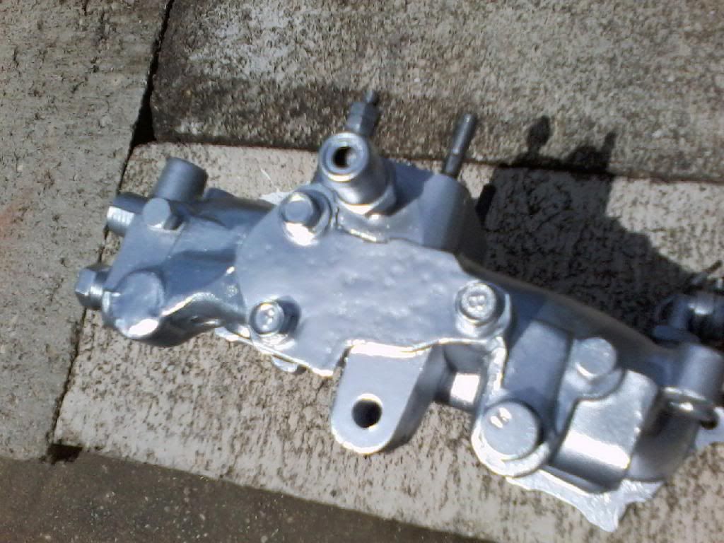

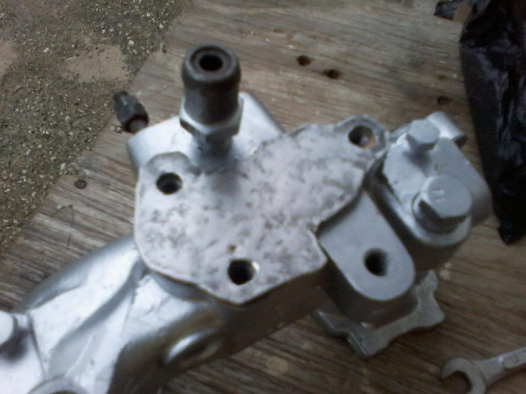

Removed EGR and studs from the intake manifoild.
Made a Gasket and Cut out piece of aliminum sheet to the shape of the EGR.
Fit to mainfoild, I used three shorter bolts so it will hold the gasket and aluminum tight and sealed it up with Silicone to prevent it from leaking!
Left it to dry and then paint,so it looks OEM.
Couldn't tell if it had an EGR !!

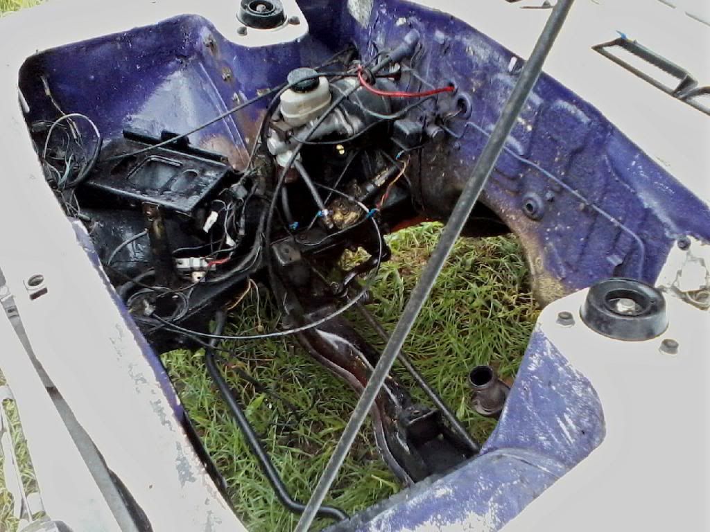

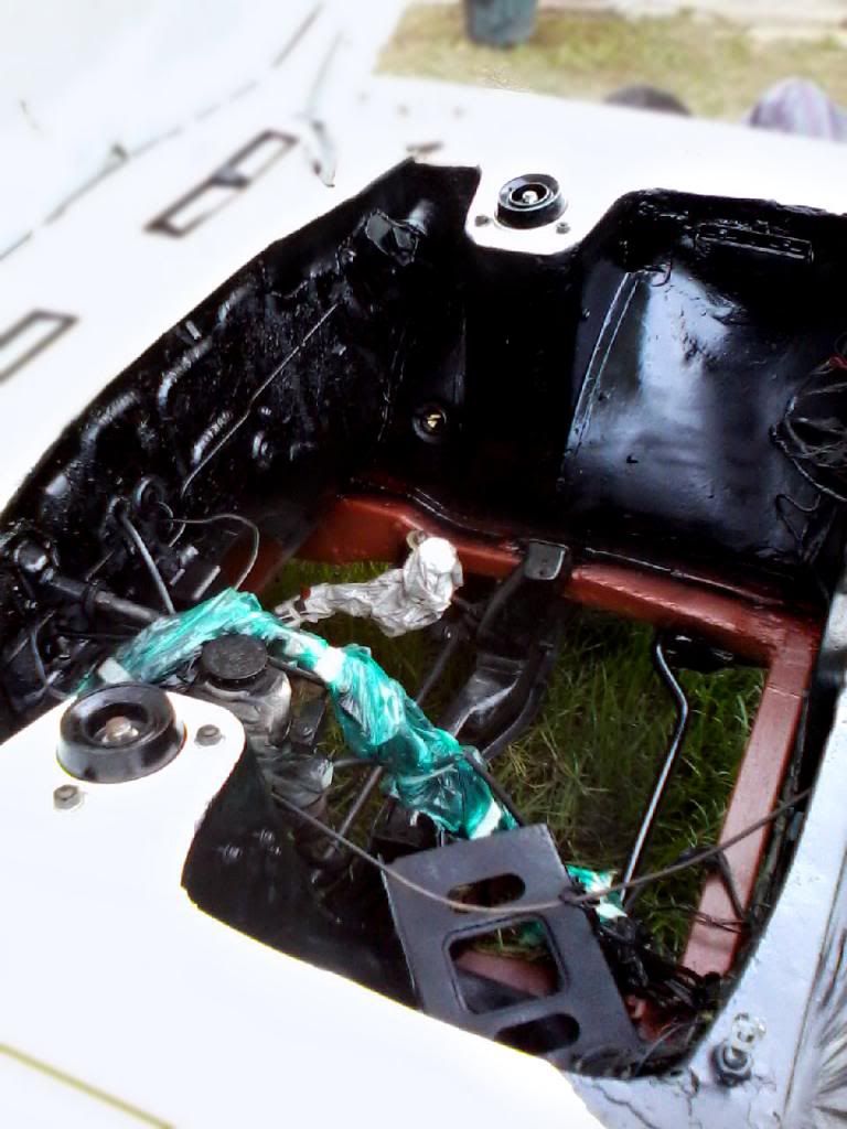

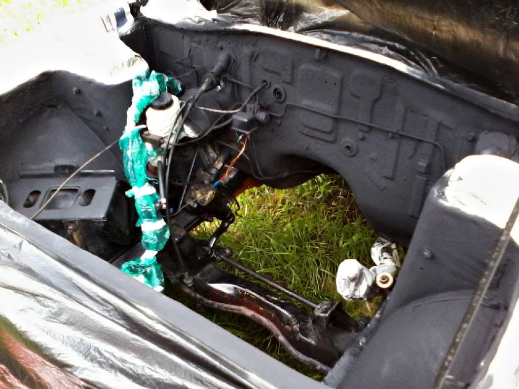

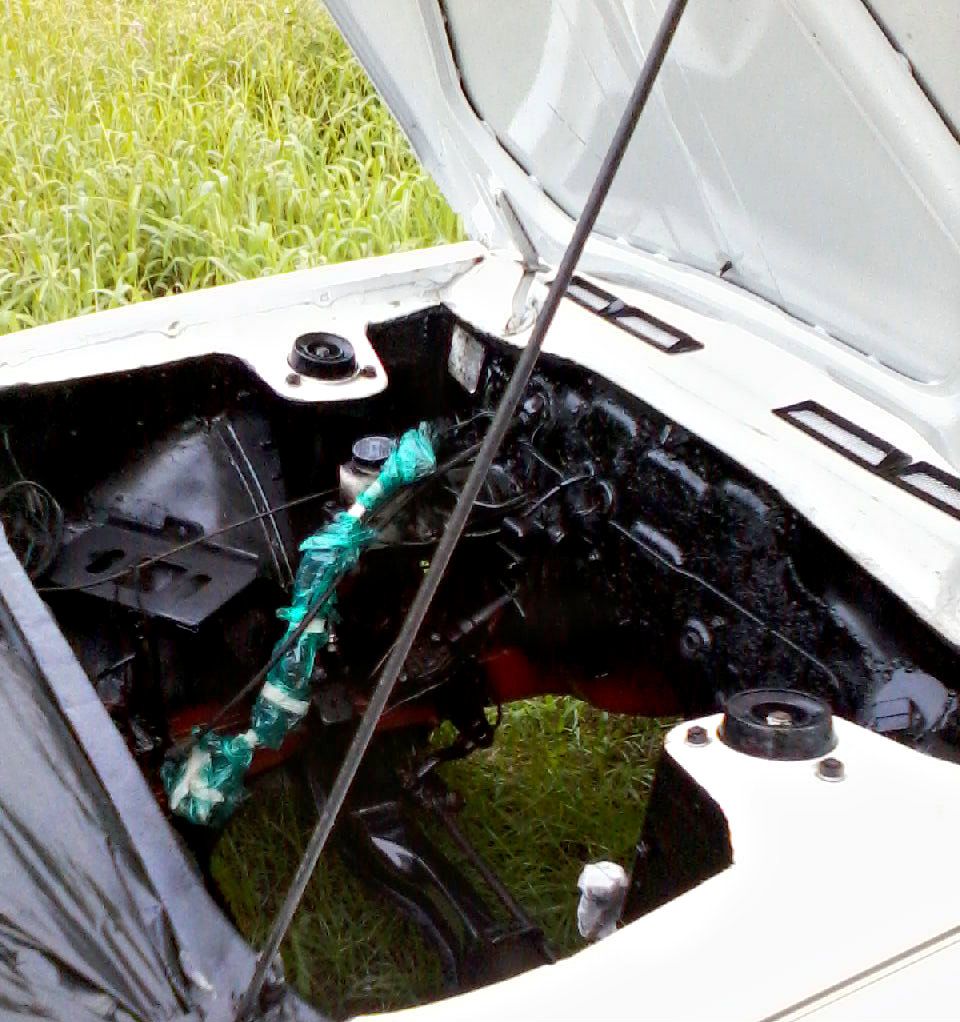

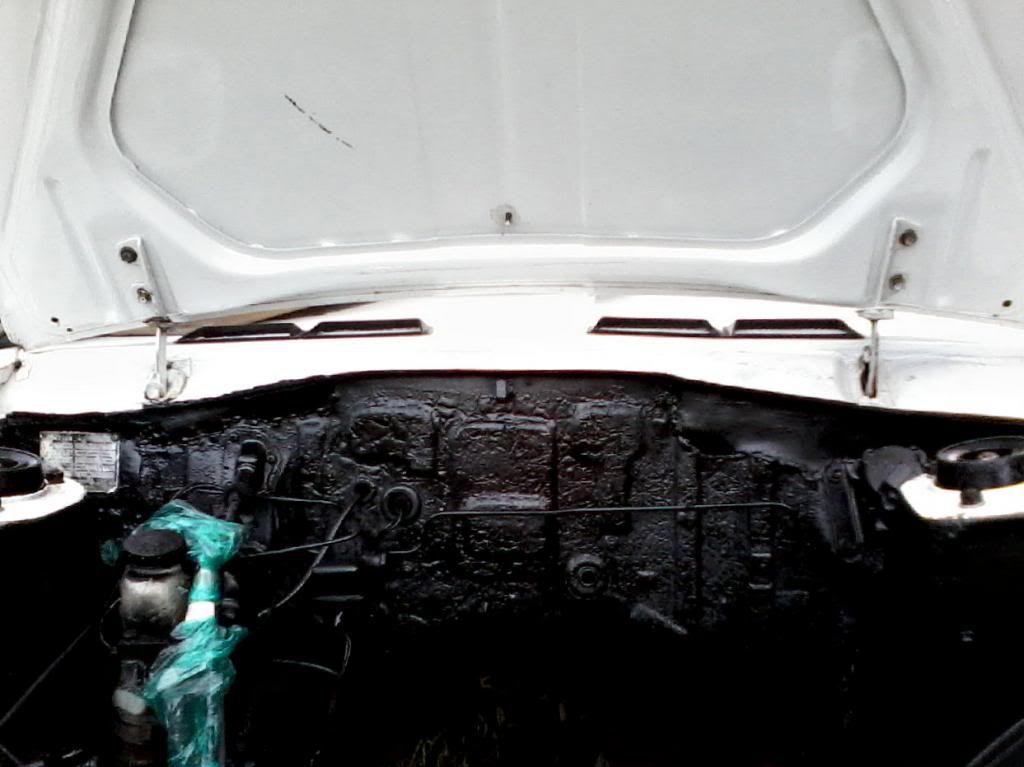

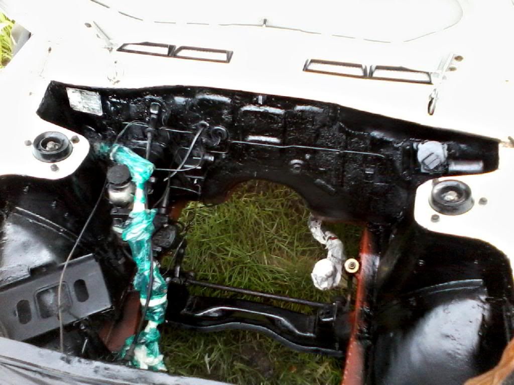

Bay taped up and sprayed looks very nice in person!

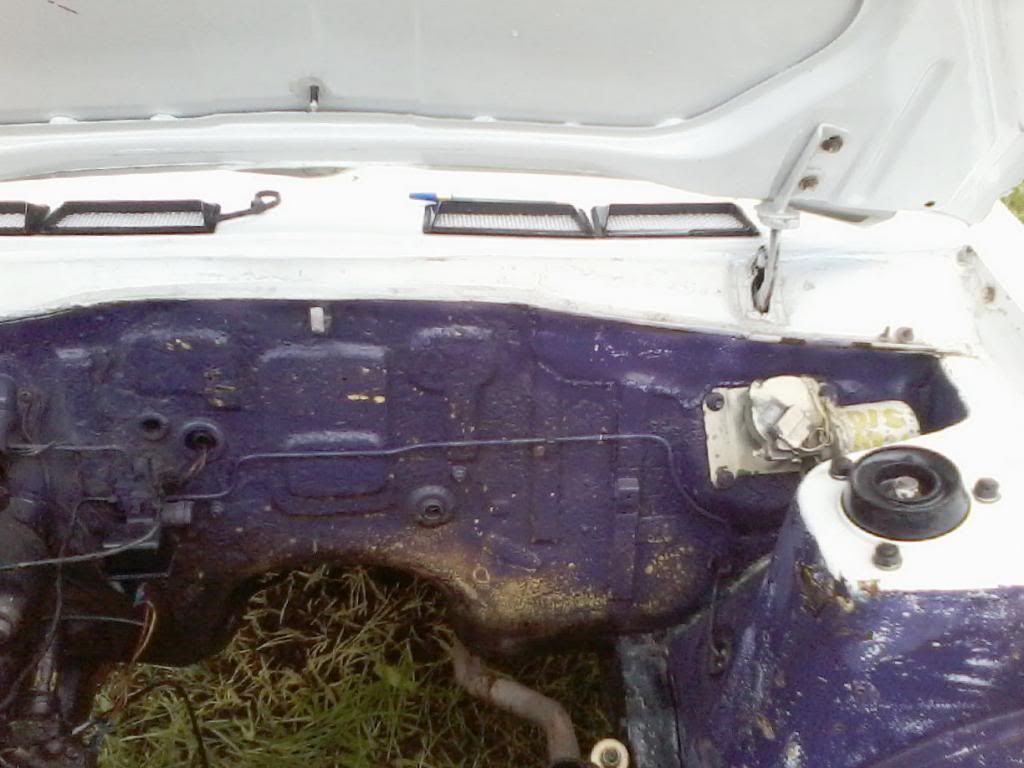

BEFORE
primed
FINISHED PRODUCT..
Came the next day and taped up the harness and all ohter crazy wires!Now looking great,Haven't got the final pic but heres whats been going on.
Need your feedback..
