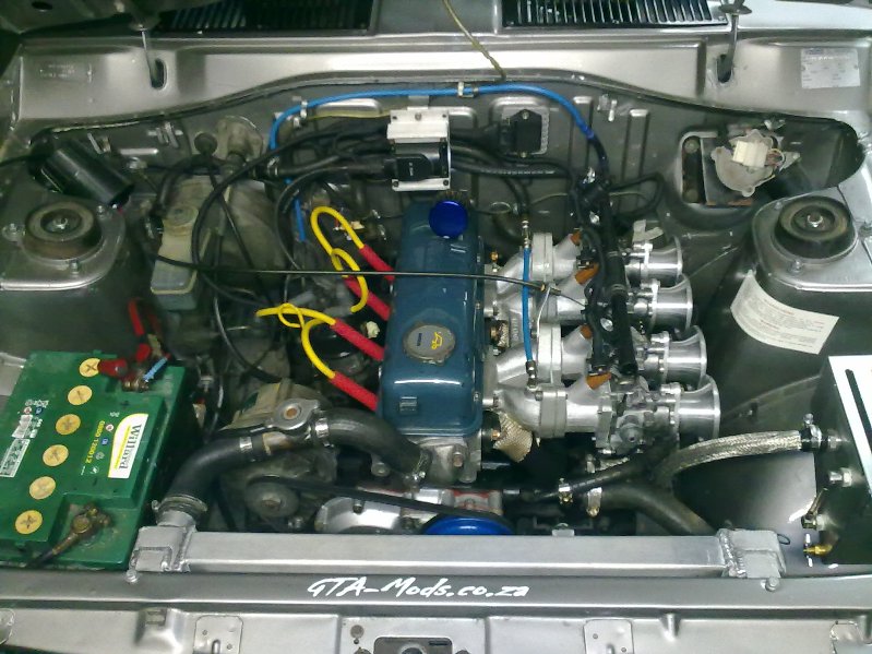

The castings look rough because the pictures are pixelated. The manifolds are a good design and they fit where they are supposed to. He's just down the road from me. They also make a conversion manifold which bolts to a sidedraught weber manifold, to which you can then bolt any of the 20V Toyota 4AGE throttlebodies. The conversion manifold has injector bosses for top feed injectors, so you only use the throttles themselves. We have done this with an A14, went quite well, but was a little on/off around town because the throttles are so big.
Video of it running http://www.youtube.com/watch?v=eI3OYuhoLO4
Both the sidedraught manifold and conversion one in these pictures come from him.

cool. It looks good in that picture.

That does look good.

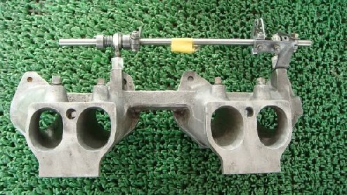

The Japanese equivalent utilises a centre bolt pattern so as the porting could be pushed a little further. They have also included vacuum port access and a smart throttle bar linkage mount.
