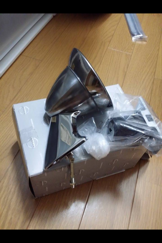

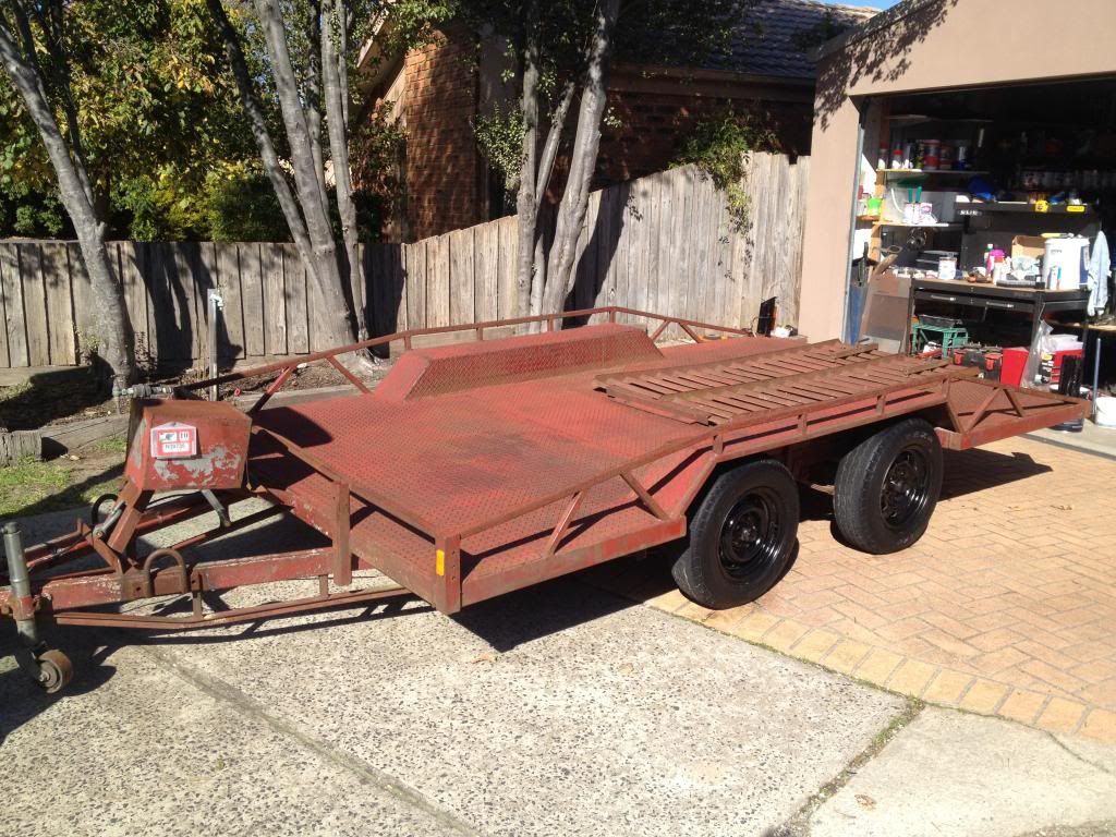

Some update, got some b510 fender mirrors to fit on the coupe, got some door trims made by trimmer to fit (cheers trimmer) got some shorter springs and some RCA spacers to fit from t3, got some stuff to cover the top of my dash. Bought a car trailer nothing flash but it will get the coupe around (thanks rallycar) hope to be picking the car up from dmdtuning this weekend all tuned on e85. Have a few things to check, fix and fit.
