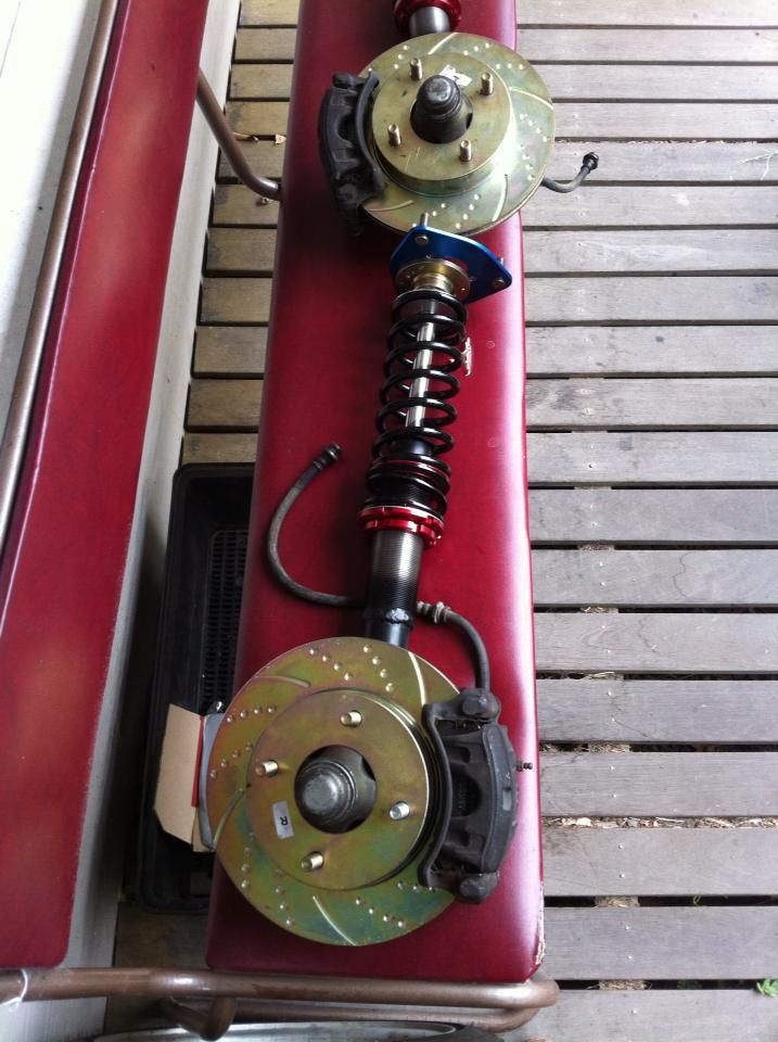

Yeah cool, Johnny is a good bloke, I so wanted to buy it but I have no need for it really :( as for the struts and brakes it's got s13 ca18 brakes fitted which clear the 13's.
Keen to see what you do to it :)
Here's the struts when I built them

When i bought the car,it didn't have the discs and calipers fitted.just the front rims on the hubs.
Fitted them a few days ago.Took me a couple of minutes to figure out ca18 right caliper with its adaptor plates goes to the left strut and vise versa on the other side...
Also had to grind the brakes abit to fit under them under 13 inch ssr mk2s on the front.
Also impressed and surprised on how smooth and comfortable your coilovers ride.Very Recommended.
Planning on getting car engineered for every mod including this suspension/brake setup for insurance purposes and RWC purposes.
The brakes also stop really well esp compared to the stock 1200 brakes im used to.
