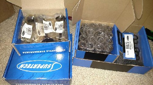

SuperTech stainless valves and 84# dual springs ready to be installed with Brian Crower Stage 2 cams.
Getting closer to completion.
