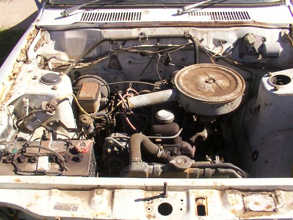

by "rusted" do you mean like this?
this ia a photo of my March 1977 Datsun 120Y (B210) 4 door sedan known as "The Defect"
from what I understand where the guards bolt on is a place where all 120Y's/B210's rust badly-I have never attempted to fix either of my 120Y shells as the rust in my 120Y is terminal, I also have a '74 4 door sedan bodyshell that is alot better condition and it is rusted there too!
I can only recomend that you take your 120Y (B210) to a few panelbeaters and get a few quotes...
or if you are a good enough welder remove the front guards and get into it!

hmmm now Mawler thanks for your input.... well in some ways its worse and in others not I guess... The strut tower is leaning in towards engine and actually up against the master brake cylinder on one side... the structural tube is completely gone but the inner fender metal is all there.... When you look close you can see they designed the tubes with a drain hole at the bottom but it allows mud and such to get up inside and then rots it from the inside out..... bad design flaw that one...

It sounds like you need a complete inner guard /fender from a donor car. Any B210 should qualify here. This will likely as not involve the services of a body shop [panelbeater] as it will need to be set up in a chassis jig to ebsure that everything is true & square, otherwise the wheel alignment will always be "off"
If the car is rare enough in Canada, & you really really want one, then maybee it's worth it, but is sounds more like a parts proposition to me.

good idea Saltwater, if the B210 is good nick apart from the rusty strut towers, if the front frame rails are good you could always cut everything from the firewall off (bar chassis/frame rails) and have an aftermarket strut or dual wishbone setup instead!
just an idea though!
