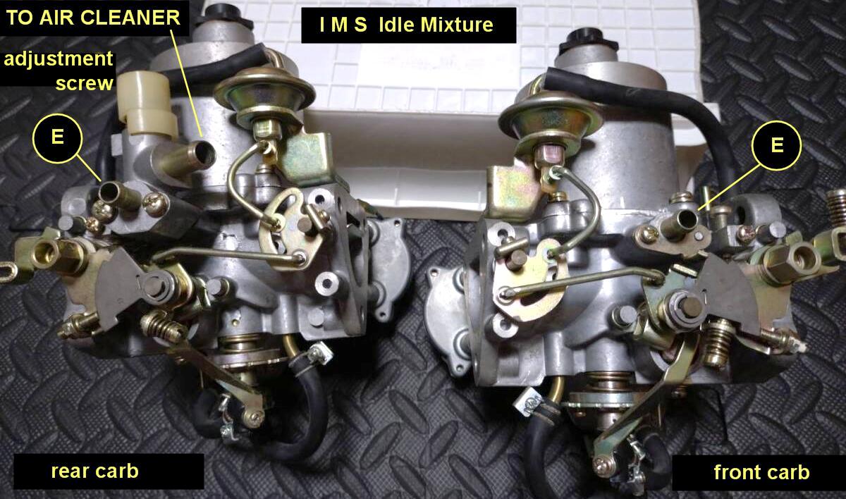

To set the air/fuel idle mixture, turn the adjustment screw

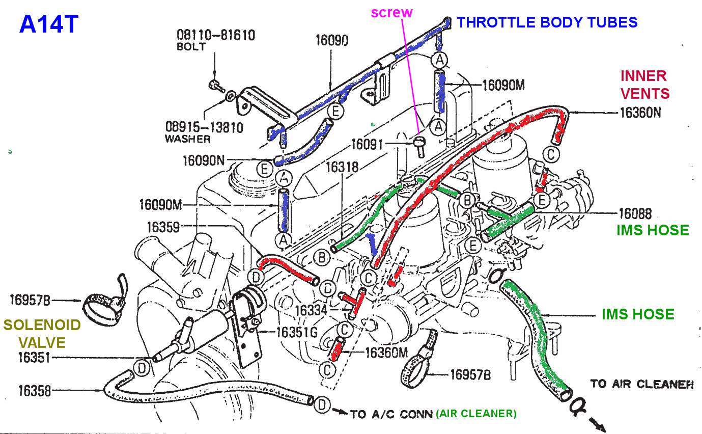

There are two hoses on the carburetors for this system:
* large hose connects to the air cleaner
* smaller T-hose connects to 'E' ports and ties into the Solenoid Valve
jpg  IMS.jpg (142.26 KB)

jpg  A14T tubes.jpg (187.14 KB)
