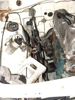

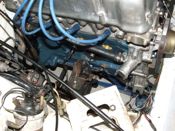

Well heres an update,

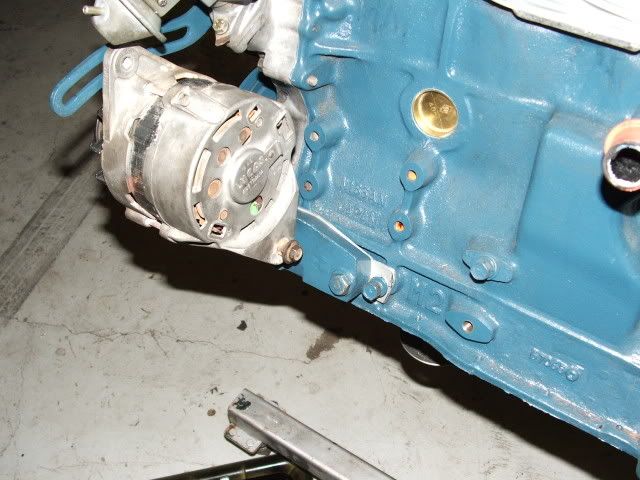

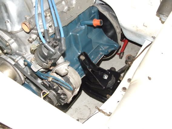

I have used a bare block, head and gearbox to test fit the L16, crossmember and engine mounts are currently tack welded with the fresh motor in the car now.
Moved the alternator to the right side of the motor to give more room for the clutch master set-up i have.
Also had to do a fair bit of gentle hammer/dolly work to the sump to fit over the crossmember.

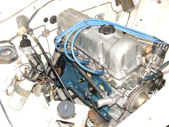

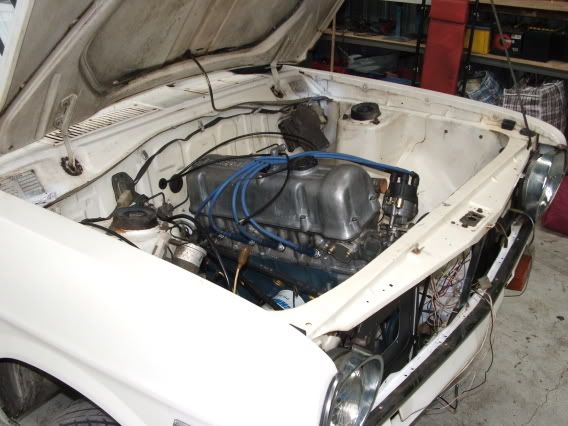

WhiteSedan Posted on: 2006/5/8 13:55
Pic of engine in car, crossmember out getting final welds and painted.

WhiteSedan Posted on: 2006/5/10 12:37

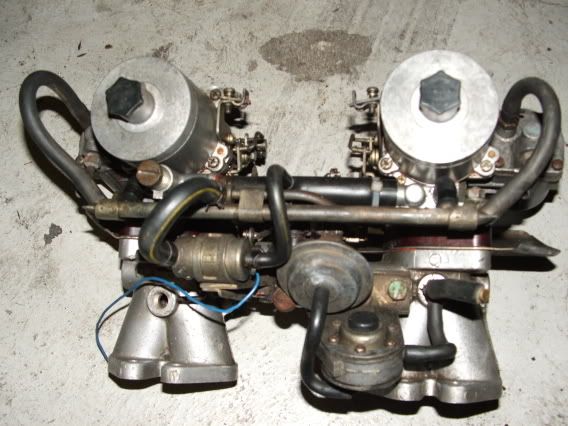

Its in! Now to rebuild my su's, anyone know anything about desmogging flat top su's? Also im after a factory aircleaner assm if anyone has one!!

The flat top SU's don't have smog equipment as such, they just have a sort of tamper proof system for adjusting the mixture and idle. Most Datsun Service Manuals show the early round top SU's which don't have that system. I've got some scans of a service manual covering the flat tops on my website...
Flat top SU's
You can blank remove the pipework and the extensions they attach to on the carbs and fit blanking plates but that leaves you with no mixture adjustment as the jets are fixed. You can make those fixed jets into ajustable ones though. The adjusters are encased in a metal tube thing which can be removed with care.
You have to gring off the rivets as shown by the red arrow in the pic below then grip the tube where the green arrow is pointed with some vice grips and unscrew the tube. When you grip this bit you need to do it hard enough to clamp the tube down onto the collar inside (green arrow second pic below) so you can unscrew it. Once it's off you can chuck the tube and screw the collar back on. They are now adjustable same as old SU's. The solenion valve is just an anti dieseling valve so you can either leave it on or remove it..up to you. Sometimes they run on after turning the engine off if you take it off.
Not sure if the Aussie flat tops are the same as ours but the chances are they are the same.
-Ed

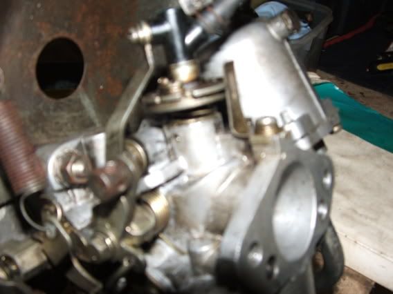

Ok heres some pics,
This one is of the top of the carbs, you can see the vacuum hose is blocked off that comes from the manifold, where does this go?
Also if i leave all the emissions on there is there much loss in power? I might leave as is just hook it all up correctly.
Heres a pic of the jet adjuster, which has adjustment
